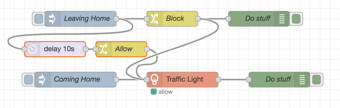

If you want to do it entirely in nodered your could do this:
[{"id":"59909777.6b7488","type":"inject","z":"d59703d6.87ebf","name":"Coming Home","topic":"","payload":"","payloadType":"date","repeat":"","crontab":"","once":false,"onceDelay":0.1,"x":160,"y":4240,"wires":[["5e92ceaa.01ff7"]]},{"id":"5e92ceaa.01ff7","type":"traffic","z":"d59703d6.87ebf","name":"","property_allow":"payload","filter_allow":"on","ignore_case_allow":false,"negate_allow":false,"send_allow":false,"property_stop":"payload","filter_stop":"off","ignore_case_stop":false,"negate_stop":false,"send_stop":false,"default_start":true,"differ":false,"x":370,"y":4240,"wires":[["209996dd.77f58a"]]},{"id":"209996dd.77f58a","type":"debug","z":"d59703d6.87ebf","name":"Do stuff","active":true,"tosidebar":true,"console":false,"tostatus":false,"complete":"payload","targetType":"msg","x":560,"y":4240,"wires":[]},{"id":"27b8ab7.9d42554","type":"inject","z":"d59703d6.87ebf","name":"Leaving Home","topic":"","payload":"","payloadType":"date","repeat":"","crontab":"","once":false,"onceDelay":0.1,"x":170,"y":4120,"wires":[["e57a2f76.d915b","78c7d033.61a3"]]},{"id":"6117a4c4.4c09ac","type":"debug","z":"d59703d6.87ebf","name":"Do stuff","active":true,"tosidebar":true,"console":false,"tostatus":false,"complete":"payload","targetType":"msg","x":520,"y":4120,"wires":[]},{"id":"e57a2f76.d915b","type":"change","z":"d59703d6.87ebf","name":"Block","rules":[{"t":"set","p":"payload","pt":"msg","to":"off","tot":"str"}],"action":"","property":"","from":"","to":"","reg":false,"x":350,"y":4120,"wires":[["6117a4c4.4c09ac","5e92ceaa.01ff7"]]},{"id":"52d74d3b.50d034","type":"change","z":"d59703d6.87ebf","name":"Allow","rules":[{"t":"set","p":"payload","pt":"msg","to":"on","tot":"str"}],"action":"","property":"","from":"","to":"","reg":false,"x":250,"y":4180,"wires":[["5e92ceaa.01ff7"]]},{"id":"78c7d033.61a3","type":"delay","z":"d59703d6.87ebf","name":"","pauseType":"delay","timeout":"10","timeoutUnits":"seconds","rate":"1","nbRateUnits":"1","rateUnits":"second","randomFirst":"1","randomLast":"5","randomUnits":"seconds","drop":false,"x":120,"y":4180,"wires":[["52d74d3b.50d034"]]}]
If have set the delay at 10 second just to show… The trick is the “Traffic light” node. Add this to your palette.
GV
This is the way to go. The Traffic Light node is immensely useful and doesn’t require you to create all these random input booleans in HA. The only time I don’t use it is if I want the condition controllable from the HA UI (e.g. Vacation Mode is On or a variable timer that can be set from HA with an Datetime Input)
Thank you, this works perfectly! im very happy now :slight_smile:
