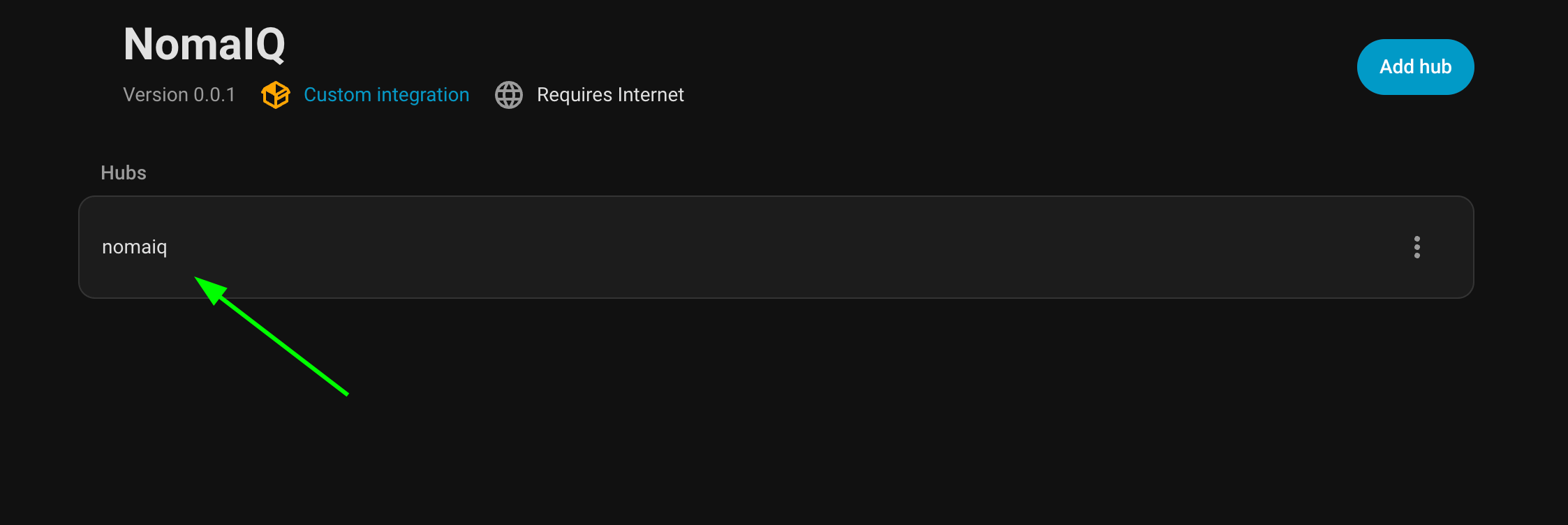

I added the integration but I only see the hub (no devices)

I was able to add the custom repo but I only have a hub showing up. Im trying to add a Noma IQ window AC. Is there any chance for you to walk me thru it? Let me know. Thanks!

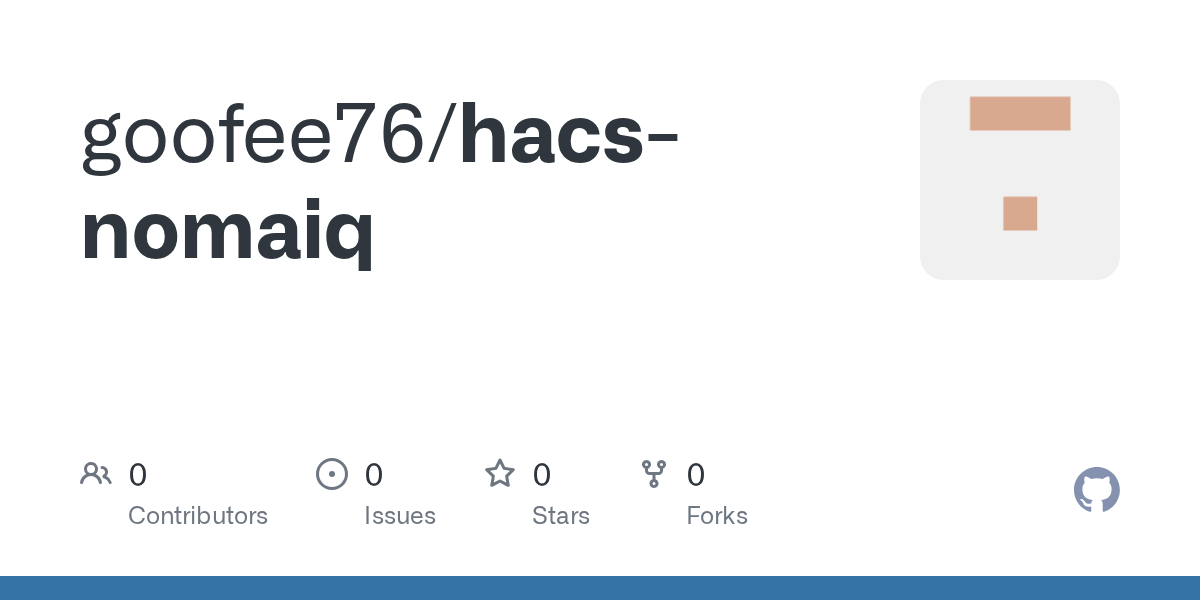

I have a Canadian Tire NomaIQ dehumidifier working with home assistant. I’m submitted a pull request, but it hasn’t been merged yet. You can check it here, let me know if it all works as expected.
I tried it and it works on my dehumidifier. Maybe this should be added to HA itself or as a separate HACS addon
