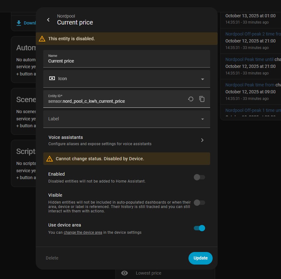

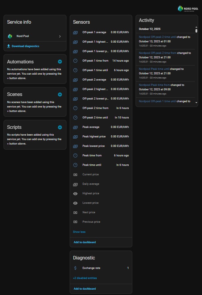

I have been trying to migrate from the Nordpool custom component to the official HA integration but I´m stuck with 6 of 24 sensors disabled by default with message “Cannot change status. Disabled by Device” and there is no way to enable it. Feels like I tried everything. Any ideas?
The sensors that are disabled are:
nord_pool_c_kwh_current_price
nord_pool_fi_daily_average
nordpool_c_kwh_highest_price
nordpool_c_kwh_lowest_price
nordpool_c_kwh_next_price
nordpool_c_kwh_previous_price

Problem solved by disable and re-enable integration. Uninstall and re-install did not solve the issue.
