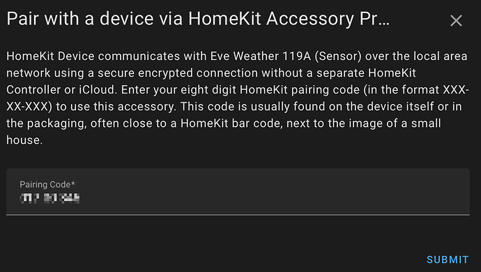

That works, to an extent. The device appears in HA:
I enter the pairing code:
And finally I get this error message:
The device is no longer added to HomeKit, and the only way I can add it back to HomeKit is to reset it. So I am not sure why I keep getting this error when migrating it to HA.
