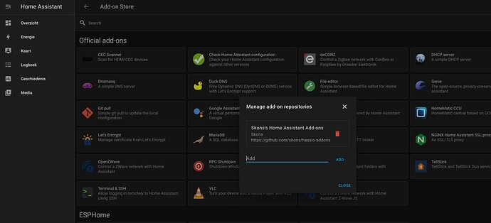

As a newby with HA I was hoping to get some things working. Such as adding a few add-on from the third party Integrations. Why is this all not working? I tried to add them using several methods. Manually placing them into the directory /HomeAssistant/custom_components/hacs and through the HA frontend using the add-on page adding the github url. If manually I know the files are in the right place and should be ready to used? loading them through the add-on tab is doing something but than nothing is available (I also do not see anything added in the directory. So nothing has been added than.
Also did a reboot start of the system after every step and refreshed the browser.
This is what I see when adding through the add-on page:

Still not getting it to work. Further investigation showed me some files which seems to be added by the add-on repository part. But do not show up in the front-end. (I added the dutch_gas_prices add-on as a test). After a second reboot they suddenly appear. And I am able to install/start it. Other add-ons are not “valid” when I try to add the repository like the https://github.com/rroller/dahua . Even tried to add that with git straight into the pi@raspberrypi4:/usr/share/hassio/addons/git but that is not working either.
An addon and a custom component (or custom integration) are completely different things.
I custom integration is an extension of what is available here Integrations - Home Assistant - it runs in python and interacts directly with Home Assistant, same as any native integration. They can be installed via HACS or by copying the files to /config/custom_components. HACS is easier. It can run in any of the 4 install methods.
An addon is “foreign” software that is not directly providing integrations, it is to run something which home assistant doesn’t depend on, but is useful, like mosquitto for mqtt, samba, node red etc. It can be written in any language and is a separate docker container. It is only available in HA operating system installs or Supervised installs.
I looked, dahua is a custom component not an addon.
I really do recommend, install HACS. https://hacs.xyz/docs/setup/prerequisites
And don’t try to add files to /config/custom_components/hacs. The installer for HACS sorts that out, and other custom components/custom integrations go in their own sub directory.

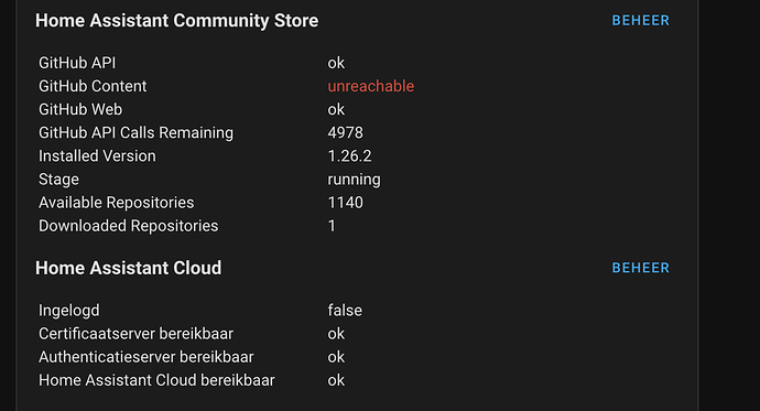

Ok now I have a new install running including HACS. I tried to install the Dahua Camera Integration through HACS but ending up with a never ending spinning circle… Waited for a long time to load but it never finishes the downloads.
You might be running into a rate limit at GitHub… :expressionless: That could explain the spinning circle…
Check under Settings > System > System Health what it says in the part about HACS, should look like this:

It says Github content unreachable. How to change that?
Fix your internet?
Look in the logs?
Follow the instructions for HACS which say to post a github issue?
