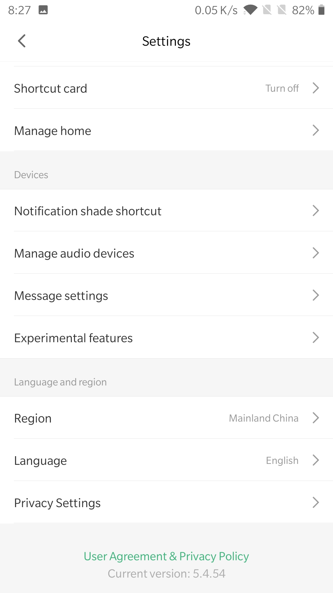

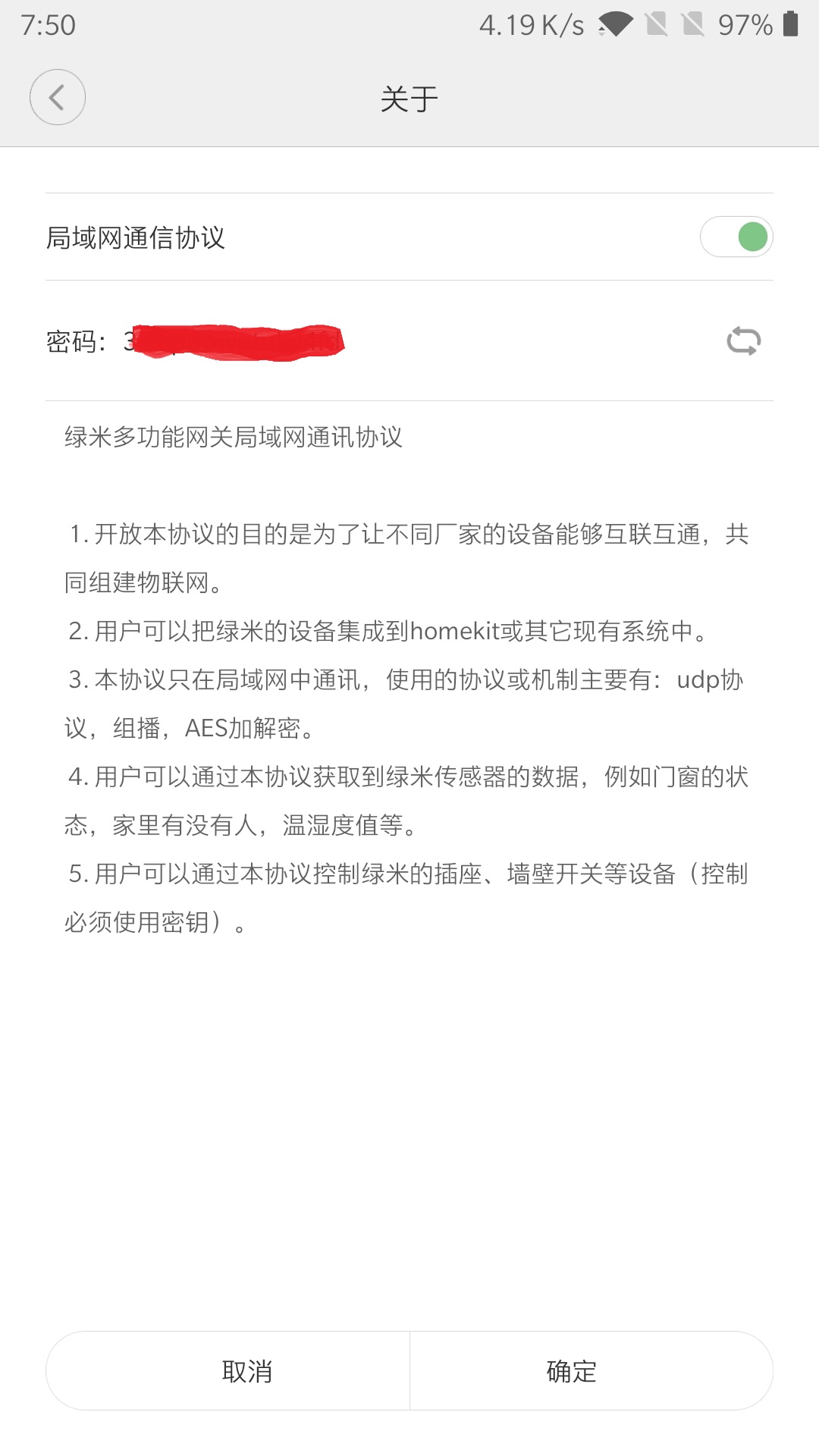

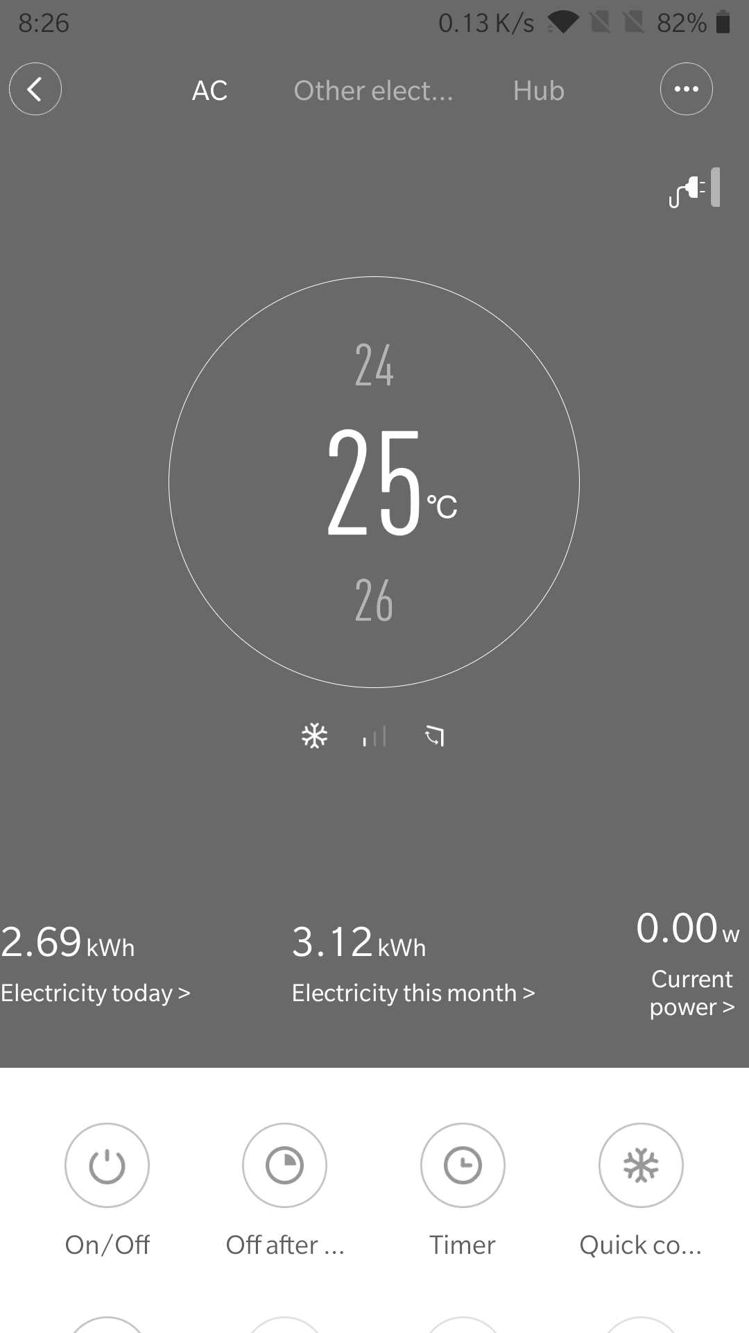

Try it on Mi Home version 5.4.54 in Android. And i get the gateway key for my AC Partner version 3. Here is what i did.
(1) Change the region to China
(2) Enter AC Partner
(3) Find the function settings
(4) Click Plug-In version multiple times
(5) Wireless protocol will show up (enter to get the key)
Thanks, this helped. It was simple enough. Found my old Android and did as described above.
Got the key OK.

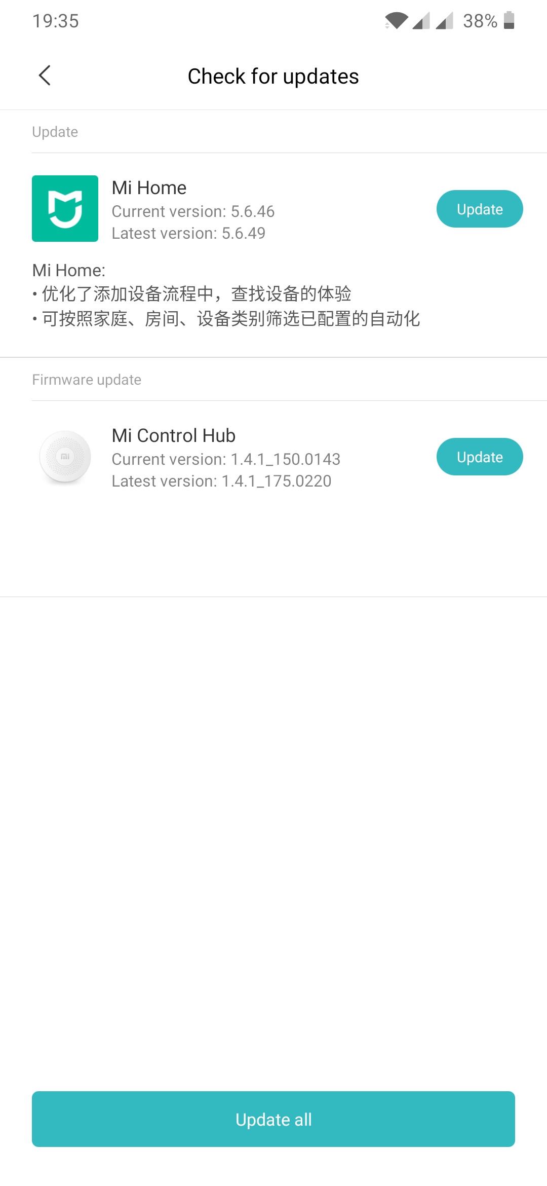

@datscharf Which is your Xiaomi GW model? It your model is: DGNWG05LM, then nothing to do so far
Yes that is exactly the model :laughing:… well sometimes you’re lucky and sometimes you aren’t
Can’t believe no one on earth found a way to activate the developer mode on the model DGNWG05LM.
Per haps try to upload the old firmware? Don’t know, we’re unlucky

On the last version of the app there isn’t the about option, now is called information.
Go inside information then on the bottom spam touch on “version plug-in” until the LAN comunication menu appear.
If you see a chinese text don’t worry and just keep clicking.
