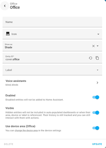

The blind/cover in question appears to be configured correctly and i’ve added some new aliases:

Change the device class to blind (“show as” field) and delete the aliasis (they assume more unique names rather than a class name).
magic! thats fix it. bet i’ll forget this when i next need it in 6 months :smiley:
i assume it would’ve worked if i said “close office shade” (i’ve been using blind & cover keywords)
Сover is a domain, there is no intent for it, уou can use this word for your own purposes. Shade, as one of the classes, will work if this type of curtain is selected.
The command for the device class is executed for all devices of this type in the room.
