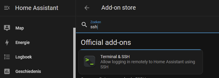

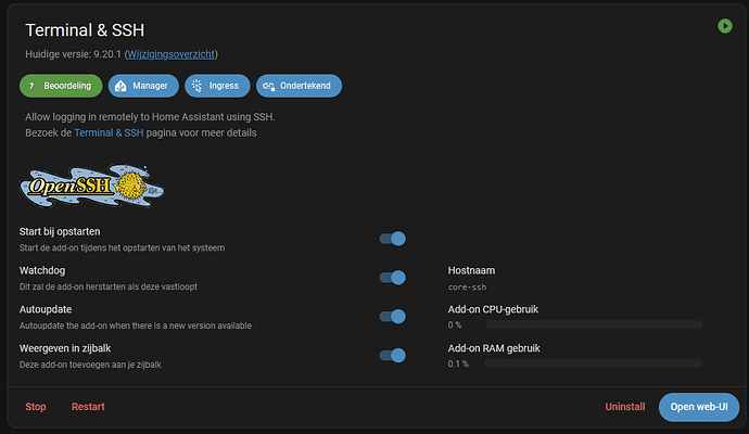

I have the same problem, and would like to know how I can access the HA command line? I feel I need to do the supervisor repair also.
You can install the add-on “Terminal & SSH” and then access the command line via the Home Assistant webinterface.
Thanks for the quick reply? I’m not finding that exact same one. I tried Advanced SSH & Terminal but I’m currently connected via DuckDNS, I think it wants a password.
Never mind, it finally appeared in the add-ons menu.
