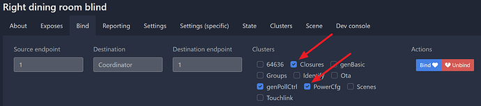

- Now switch to the “Bind” tab. You’ll want to be sure the “Closures” and “PowerCfg” checkboxes are selected. Then click the blue “Bind” button on the right.
For me, this brought back the functionality of Home Assistant being able to monitor the position of the blinds (0% is fully open, 100% is fully closed, and anything in between), and be able to open or close them to any arbitrary position.
