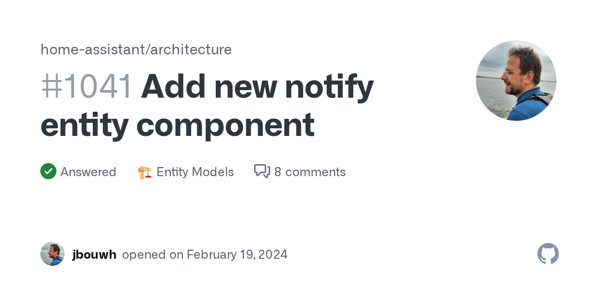

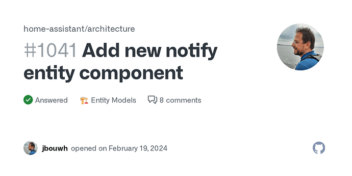

TLDR: The legacy notification actions are supposed to be deprecated, a new system of notification entities that are targets has been set up with a few actions to post to them.
