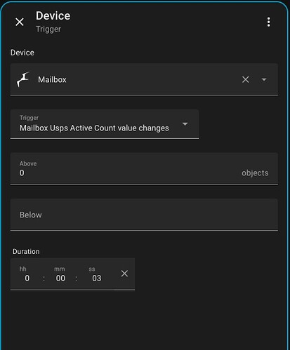

good call - by apologies. thought I included the yaml script.

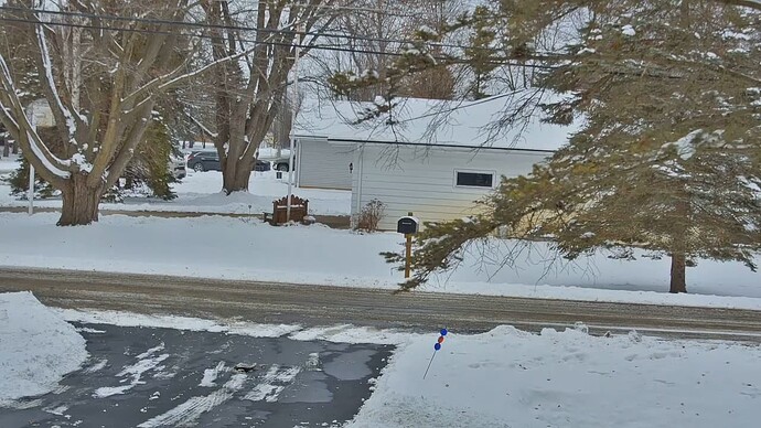

But since this doesn’t give the visual of the device, here is a picture too.
alias: USPS
description: “”
triggers:
  • type: value
    device_id: a6b140cb9d94b6154bb9eb8833772708
    entity_id: db4fecf0eecf0d2a2ef3a57c52926cd0
    domain: sensor
    trigger: device
    above: 0
    for:
    hours: 0
    minutes: 0
    seconds: 3
    conditions:
    actions:
  • action: notify.send_email
    metadata: {}
    message: USPS
  • action: notify.nhbalert
    metadata: {}
    message: USPS
    mode: single

Interesting idea. The cameras I have are a dual setup, main and sub are pulled in by Milestone, and Frigate also uses the sub stream. I’ve gone back over the milestone footage and the time HA sends out the notification is pretty much spot on to what the Milestone timestamp of the post truck stopping is.
So I guess at the moment I’m not as concerned with the time delay.
The camera I have used for the mailbox is zoomed in so that is pretty much the the mailbox is the main thing in the frame, and it’s an old country road so not terribly wide.
There are 5 mailboxes prior to mine, so depending on how much stuff needs to be crammed into each box, the time is usually all of 5-7 minutes from when the truck flies by to when it actually stops right at the mailbox. That branch is weighed down by snow, but usually it’s not blocking the view of the mailbox during the warmer months. even so Frigate detects the usps logo just fine with the branch there.
