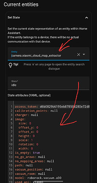

Secondly, could you navigate to this page:
And send me a screenshot of what can be seen in this field:
Feel free to message me directly instead if it concerns some private information that needs to be redacted.
I did not have a camera myself when I implemented the snapshots feature and built it based on documentation purely, so it would be a golden opportunity to get real usage information wherever I can.
