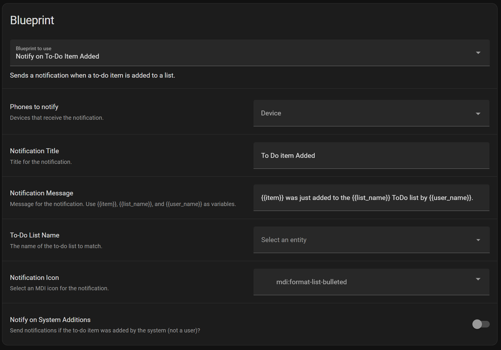

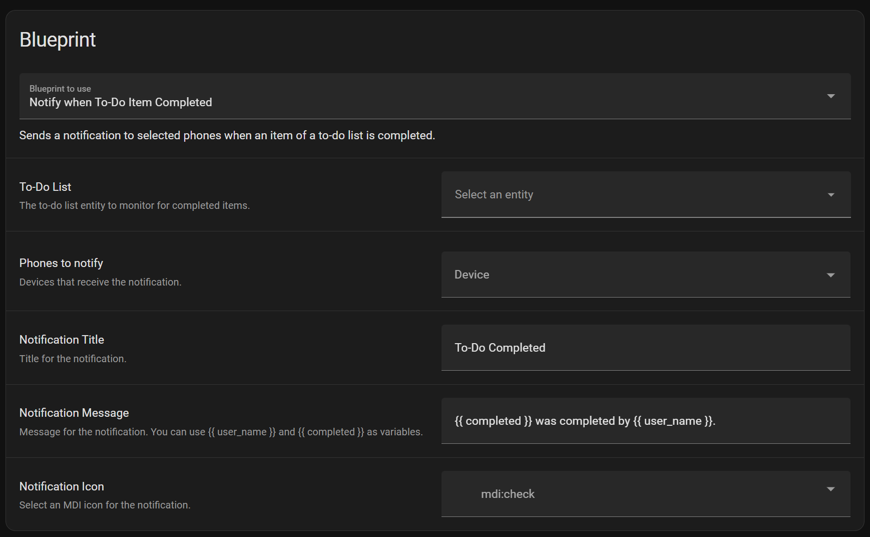

I am trying to work with this to get to this behavior:
  • When an item is added:
    notify message: “Bananas added to the shopping list by %username%”.
  • When an item is completed:
    notify message: “Bananas crossed off the shopping list by %username%”.
Any idea on how this can be done?
I’ve been trying to do this too and I don’t think it can be done. Because the automation is not triggered by a user, it’s triggered by the shopping list.
So any notifications being “sent” is being “sent” by the shopping list.
