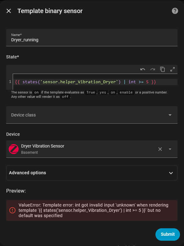

Hey there, would you mind showing how you set this up? I tried creating a Template Helper (using the Binary Sensor type), copied the state code in, but get this error message:
Edit: figured it out seconds after posting this: For anyone after me, don’t copy in the brackets!
@ coolsaber57
How did you get to that menu ?
I thought that I had a grasp on this by adding a Helper boolean “dryer running”.
And renaming my Vibration sensor entity “third_reality_inc_3rvs01031z_motion”
But there is clearly some steps that I am missing that seem to be already implied to others.
UPDATE: I found TEMPLATE instead of BOOLEAN as a helper type and figured it out.

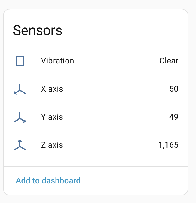

A quick side note on the Third Reality Vibration sensor (I use a 3RVS01031Z) to monitor my AC - to check if its running when it shouldn’t be.
Unfortunately it tends to eat batteries, since its sends updates every second whilst it is detecting motion (I haven’t found a way of stopping it doing that) hence:
  • Battery life is good if it isn’t triggered often.
  • But it only lasts a few months if it’s often detecting motion.
On the plus side it only uses 2 x AAA batteries, but its still a bit annoying.

This is because the sensor actually shows up like this:
  • Boolean sensor that indicates if vibration is detected/clear (on/off)
  • Separate sensors for movement in X, Y an Z directions.
So I am accounting for two issues:
  • Firstly if you have a battery failure the device can get stuck in the “on” (motion detection state).
  • The boolean sensor only changes if the state changes (clear/detected) where as the motion sensors constantly change due to the vibration.
