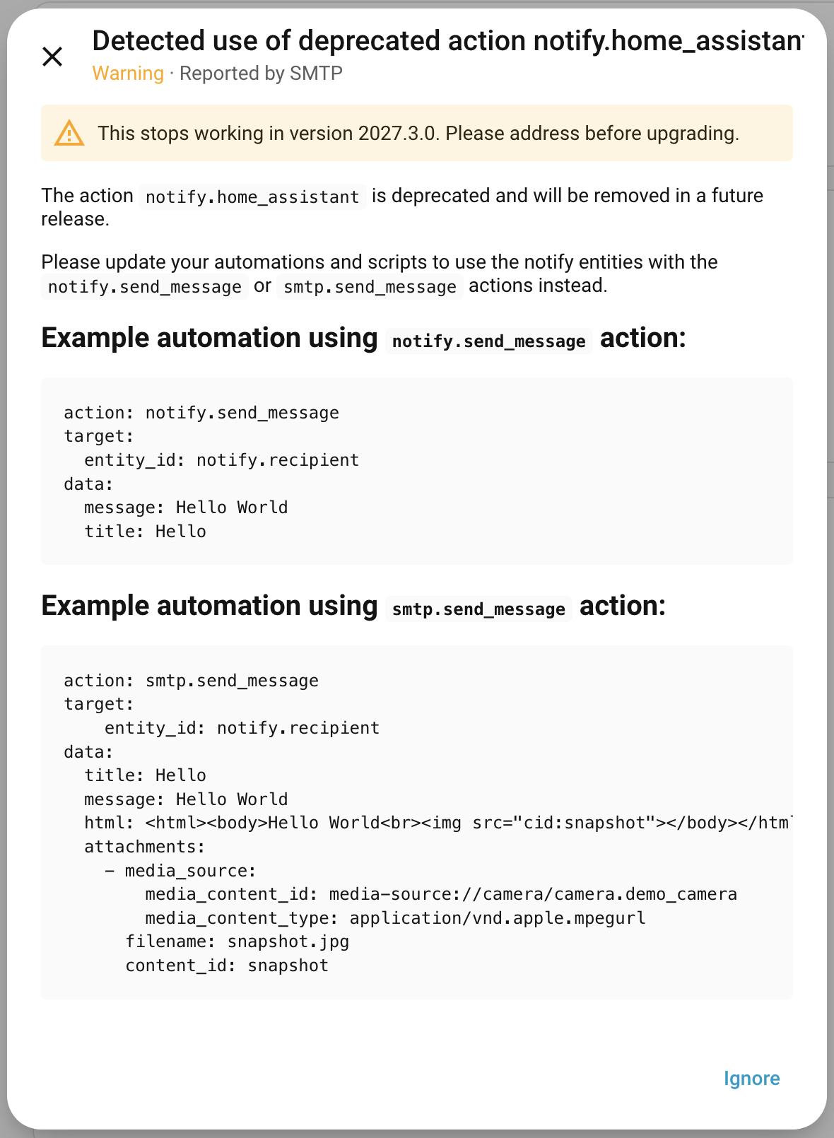

I’m seeing the message below on the updates tab, but I can’t figure out where it is being triggered or how to fix it.
I can’t find anything using notify.home_assistant, I have no scripts, no actions, all my stuff is done in Node Red and that has an smtp node plus i message the companion app a lot.
What would i be searching for so that I can fix this before it disappears and becomes a bigger issue please?
Thanks in advance

The SMTP integration is working and setup fine, I have tested it using Dev Tools and send_message works well on both my recipients.
Update…
ChatGPT has identified the source-code error in the one integration using this service and shown me what needs to be done. It is still calling the old notify service and triggering this warning.
I will try passing this info back to the developer.
