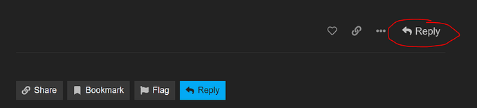

First things first. Please hit the Reply button underneath the post itself (not the blue one) when you’re replying to someone, otherwise they won’t get notified of your reply.
