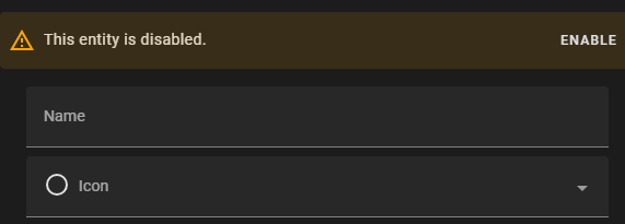

It takes at least 30 second to be enabled. You need to be patient and check it again.
You can either use the Enable button:
Or the switch, but if you use the switch then you need to press the update button at the bottom:
Hi Gabor,
Thanks for your answer. I was patient enough, but your hint regarding the switch did it! When i clicked on “activate” and saved, it turned deactivated again. But when I used the switch, it stayed active. The only thing that was strange is that only the NOUS smart plugs had this behaviour while activating hidden entities. With other devices the activate button did what he should do.
