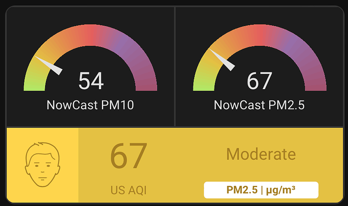

Thats it! This sensor now allows you to get a NowCast PM10 value based on local measurements.
