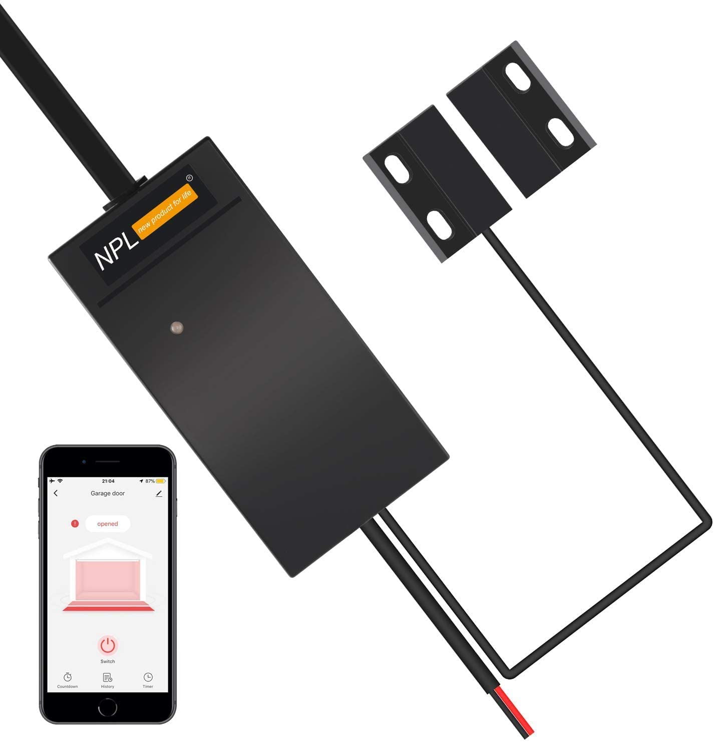

Hi all, newbie here. Do any of you know anything about this “NPL” brand garage door opener? It popped up on Amazon when I searched “Tuya.”
I actually just bought a Shelly 2.5 and some wired reed switches to control my two garage doors but at $15 each, two of these NPL kits would cost me less and presumably be less hassle.
I’d appreciate any reviews, tips, or caveats emptor.
