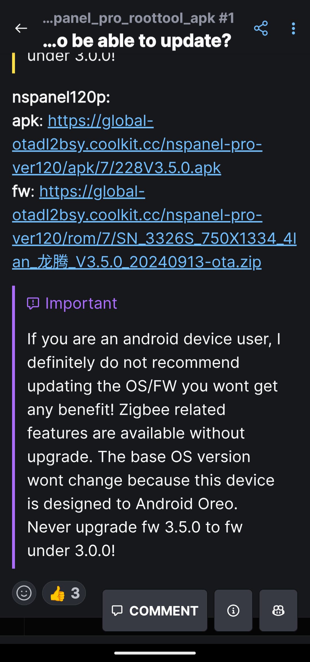

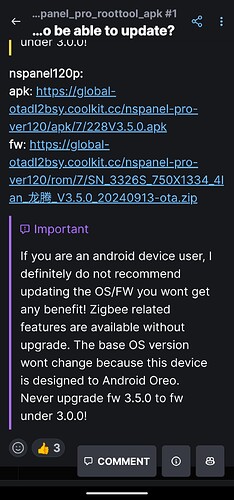

8 never updated the firmware based on the post below which might be why some people are having issues with the proximity sensor. One post said it quit working after a firmware update. The below screenshot is from the person who wrote nspanel tools.
