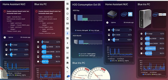

I’ve finally found the time to start tweaking my styles. Thanks for all the ideas (and code) in this thread. I’ve got this card working, but with a pretty big caveat. I’m sure I have something set completely out of bounds, but I have yet to find it.
It started off looking great, with the exception of the refresh every ~15-30 seconds. I didn’t think too much about it, and just kept tweaking things. It became more than an annoyance when I noticed it was started to affect my workstation. It managed to gobble up at least 6G of RAM in a short period of time. I removed the card and the RAM was immediately returned to me.
The first thing I did to troubleshoot was hit F12 in my browser and have a peak at the console. There was a very thoughtful message from card-mod telling me I should probably load this in the frontend, so I did.
/config/configuration.yaml
frontend:
extra_module_url:
- /hacsfiles/lovelace-card-mod/card-mod.js
I did a hard refresh in my browser and didn’t notice any difference. This is when I removed the card, created this gist with the contents of the RAM stealing card I concocted, and wrote this post.
Any tips on how to resolve this are much appreciated. Note: It’s late and I have not re-read all the various card manuals I have recently installed. I may very well be missing something obvious.
TIA
This card is a combination of many custom cards, many of them are not maintained by the dev team. They may have bugs, like a memory leak. Remove pieces of the card until the memory leak goes away. then add things back until it appears again. This will help you figure out where the leak is coming from. Once you figure that out, you can start to correct the leak. Correcting the leak may require you to notify the developer of the custom card that’s causing the problem. Last time I used this setup (~late 2019), there was no memory leak.

I used your code… It’s funny that when I create the card I get the “custom element doesn’t exist: hui-vertical-stack-card” message. However if I save the card anyway and press the “Add Card” button so the cards menu appear, and cancel right after it apears, the NUC monitor card appears… BUT… If I refresh the browser the “custom element doesn’t exist: hui-vertical-stack-card” message appears again… and so on… Any ideas?

The fix was found here: UPS System Monitoring Card
by barsurfer
Basically install “hui-element” on HACS then change:
- type: custom:hui-vertical-stack-card
to:
- type: custom:hui-element
card_type: vertical-stack
