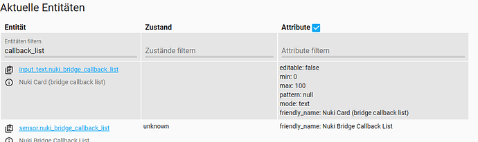

Show me this in Dev Tools after restart:
{{ state_attr('sensor.nuki_bridge_callback_list','callbacks') }}

I prayed nothing happned. But no surprise, the pope is near to you not to me. The dev. tool showed Nothing at all?!

If the dev tool showed you nothing, try this: go into Dev Tools, States section, and where you see the red rectangle in the following screenshot write callback_list. It should filter all entities with that value, show me the result.

Peter, that sensor is not initialized, that’s the root cause of your problems, it means that the REST call doesn’t work, but it’s really strange…only that one doesn’t work? Do the same thing and put the string nuki_bridge_endpoint, I want to see the other REST sensors status.
