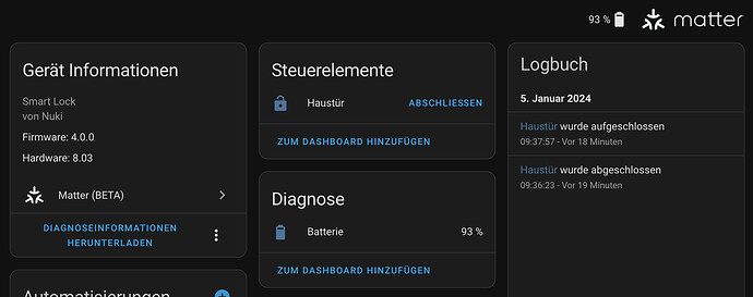

I have a new Nuki 4 (no PRO and no bridge or anything else), which I added to Apple Home via Matter using a Homepod.
My HA instance is a docker container (no supervised install). I’ve created the matter server with docker (GitHub - home-assistant-libs/python-matter-server: Python server to interact with Matter) and connected with the integration in HA. So the HA or Matter instances has no own thread or bluetooth interface.
I’ve activated the pairing for the Nuki in the Apple Home App, opened the Home Assistant App and added a Matter device… After a few tries (read and follow the instructions on the matter server readme about ipv6), it was working.
Congratulations! Did you use the iPhone Home Assistant App, or the Android version?
iPhone, as I added the Nuki to Apple Home. But I think it schouldnā€˜t be to much different on Android.
The Nuki needs to be added to a thread/matter-compartible Apple, Google, Samsung or Alexa bridge. Than enable the pairing mode for Nuki in the corresponding app.
The sharing between matter bridges should work with all vendors. This isn’t a apple feature.
Adding in HA should be the same as on iPhone: Settings > Devices > Add Matter device… than scan QR code or enter paring code.
