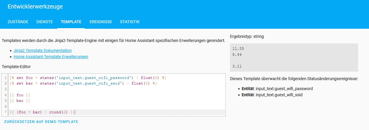

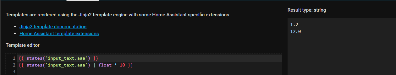

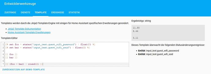

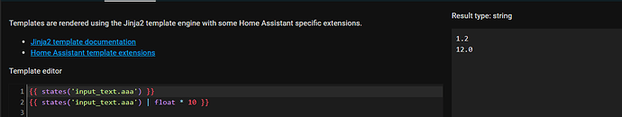

I need to use the value entered in a template calculation. I did try using a text field, but the calculation always converted the digit text entered as 0.
