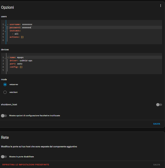

First of all i downloaded and installed the nut addon, configured it and then started it. All was going properly. Then i tried to install the NUT integration, put inside it the username and the password i chosed into the addon, put the IP address of my raspberry pi4, but i always get this error:
Is all correct what i did? Or maybe i was somewhere wrong?
The config into the addon is:

OK I have dug a little deeper. Based on what I have read so far. Understand I am trying to help! Your default username:password based on your model is apc:apc if you have changed it then enter those.
In the add-on set the driver to usbhid-ups and the port to auto
In the NUT integration specify the host as a0d7b954-nut (the hostname of the NUT add-on whatever it may be!)
Use the port as 3493 , and the username and password you configured in the NUT add-on.
You were not specific about your configuration so I have had to assume a great deal! I hope that it helps?
Wow, it works!!!
