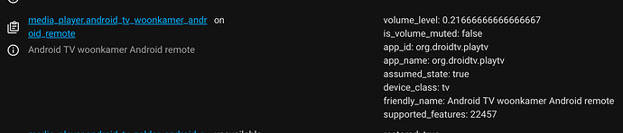

It is hard to tell what this device trigger does. In this case a state trigger would be what you need. In order to see what state you are aiming for, go to the developer tools, search for the entity of the media player you are interested in. Now perform the action you want to react to, and see what the state changes to. It looks something like this:
Most likely, in this case, the state is on, but it may also be something else, like playing. Use that as to: in the state trigger. You may also want to consider putting both on and playing in the trigger, but start with only one and expand if you miss some events.
