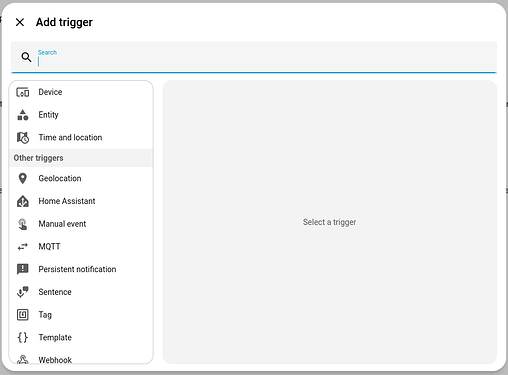

When you start writing automations, a device trigger seems the obvious choice. Everybody knows what a device is and it comes at the top of the UI dropdown list.
It works… but it is not a the best way to start because it is storing up problems for the future. Far better to use an entity, with state or numeric_state.
