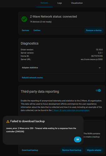

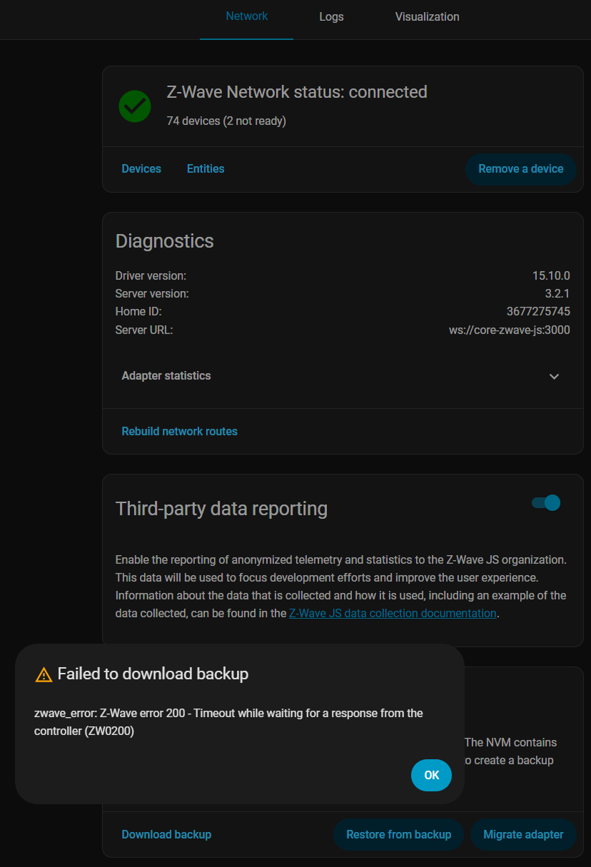

Using the new backup in zwavejs I get:
2025-08-10 21:17:07.589 CNTRLR Backing up NVM…
2025-08-10 21:17:07.589 CNTRLR Turning RF off…
2025-08-10 21:17:07.597 CNTRLR Stopping hardware watchdog…
2025-08-10 21:17:09.237 DRIVER Dropping message because it contains invalid data
2025-08-10 21:17:09.238 DRIVER Dropping message because it contains invalid data
2025-08-10 21:17:09.239 DRIVER Dropping message because it contains invalid data
2025-08-10 21:17:09.245 DRIVER Dropping message because it contains invalid data
2025-08-10 21:17:09.246 DRIVER Dropping message because it contains invalid data
2025-08-10 21:17:09.248 DRIVER Dropping message because it contains invalid data
2025-08-10 21:17:09.249 DRIVER Dropping message because it contains invalid data
2025-08-10 21:17:09.262 DRIVER Dropping message because it contains invalid data
2025-08-10 21:17:17.627 CNTRLR Turning RF on…
Z-Wave error ZWaveError: Timeout while waiting for a response from the controller (ZW0200)
at Driver.sendMessage (file:///usr/src/node_modules/zwave-js/src/lib/driver/Driver.ts:7057:23)
at ZWaveController.externalNVMReadBuffer (file:///usr/src/node_modules/zwave-js/src/lib/controller/Controller.ts:8013:33)
at ZWaveController.backupNVMRaw500 (file:///usr/src/node_modules/zwave-js/src/lib/controller/Controller.ts:8376:29)
at ZWaveController.backupNVMRaw (file:///usr/src/node_modules/zwave-js/src/lib/controller/Controller.ts:8344:11)
at ControllerMessageHandler.handle (file:///usr/src/node_modules/@zwave-js/server/dist-esm/lib/controller/message_handler.js:164:36)
at Client.receiveMessage (file:///usr/src/node_modules/@zwave-js/server/dist-esm/lib/server.js:134:62) {
code: 200,
context: ‘response’,
transactionSource: ’ at Driver.sendMessage (file:///usr/src/node_modules/zwave-js/src/lib/driver/Driver.ts:7057:23)\n’ +
’ at ZWaveController.externalNVMReadBuffer (file:///usr/src/node_modules/zwave-js/src/lib/controller/Controller.ts:8013:33)\n’ +
’ at ZWaveController.backupNVMRaw500 (file:///usr/src/node_modules/zwave-js/src/lib/controller/Controller.ts:8376:29)\n’ +
’ at ZWaveController.backupNVMRaw (file:///usr/src/node_modules/zwave-js/src/lib/controller/Controller.ts:8344:11)\n’ +
’ at ControllerMessageHandler.handle (file:///usr/src/node_modules/@zwave-js/server/dist-esm/lib/controller/message_handler.js:164:36)\n’ +
’ at Client.receiveMessage (file:///usr/src/node_modules/@zwave-js/server/dist-esm/lib/server.js:134:62)’
2025-08-10 21:17:28.835 CNTRLR Backing up NVM…
2025-08-10 21:17:28.835 CNTRLR Turning RF off…
2025-08-10 21:17:28.841 CNTRLR Stopping hardware watchdog…
2025-08-10 21:17:30.466 DRIVER Dropping message because it contains invalid data
2025-08-10 21:17:30.467 DRIVER Dropping message because it contains invalid data
2025-08-10 21:17:30.475 DRIVER Dropping message because it contains invalid data
2025-08-10 21:17:32.306 DRIVER Dropping message because it contains invalid data
2025-08-10 21:17:32.340 DRIVER Dropping message because it contains invalid data
2025-08-10 21:17:32.347 DRIVER Dropping message because it contains invalid data
2025-08-10 21:17:32.361 DRIVER unexpected response, discarding…
2025-08-10 21:17:33.932 DRIVER Dropping message because it contains invalid data
2025-08-10 21:17:33.940 DRIVER no handlers registered!
2025-08-10 21:17:33.947 DRIVER Dropping message because it contains invalid data
2025-08-10 21:17:38.936 DRIVER Dropping message because it contains invalid data
2025-08-10 21:17:38.942 DRIVER Dropping message because it contains invalid data
2025-08-10 21:17:45.729 CNTRLR Turning RF on…
2025-08-10 21:17:50.532 DRIVER Attempting to recover unresponsive controller by reopening the serial port…
2025-08-10 21:17:51.796 DRIVER Serial port reopened. Returning to normal operation and hoping for the best…
2025-08-10 21:18:02.317 CNTRLR « [Node 104] received wakeup notification
2025-08-10 21:18:02.317 CNTRLR [Node 104] The node is now awake.
2025-08-10 21:18:02.567 CNTRLR » [Node 104] Sending node back to sleep…
2025-08-10 21:18:02.591 CNTRLR [Node 104] The node is now asleep.
2025-08-10 21:20:23.037 CNTRLR Backing up NVM…
2025-08-10 21:20:23.037 CNTRLR Turning RF off…
2025-08-10 21:20:23.044 CNTRLR Stopping hardware watchdog…
2025-08-10 21:20:24.673 DRIVER Dropping message because it contains invalid data
2025-08-10 21:20:33.054 CNTRLR Turning RF on…
2025-08-10 21:20:36.252 DRIVER Dropping message because it contains invalid data
2025-08-10 21:20:37.855 DRIVER Attempting to recover unresponsive controller by reopening the serial port…
2025-08-10 21:20:39.108 DRIVER Serial port reopened. Returning to normal operation and hoping for the best…
2025-08-10 21:20:53.180 CNTRLR [Node 060] treating BasicCC::Set as a report
2025-08-10 21:20:53.234 CNTRLR [Node 060] treating BasicCC::Set as a report
it does not backup… Whats wrong?

I thought this version would work but searching around it appears to be a known problem with a fix coming:
Correct, I opened that request.
