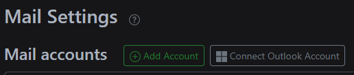

This enabled the microsoft connect button in paperless-ngx

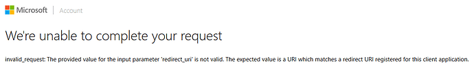

At this point I’m stuck at the following point when the redirect should happen:
I think this must have something to do with my Nginx Reverse Proxy and I’ve looked up many posts from other people having the same problem but I’ve seen no real solution to that.

The issue was living shorter than I expected it to be.
I managed to fix it myself after reading through the redirect_url which paperless-ngx has generated for microsoft, I saw that there was an issue with the url containing /paperless twice
xyz.myfritz.net/paperless/paperless/api/oauth/callback/
The config part in paperless-ngx which I took from another guide which obviously didn’t make sense with my nginx path and resulted in a wrong redirect_url path:
PAPERLESS_OAUTH_CALLBACK_BASE_URL=https://xyz.myfritz.net/paperless
Removing the /paperless from this path fixed the issue for me.
I hope this helps anyone else stumbling upon this in the future.
