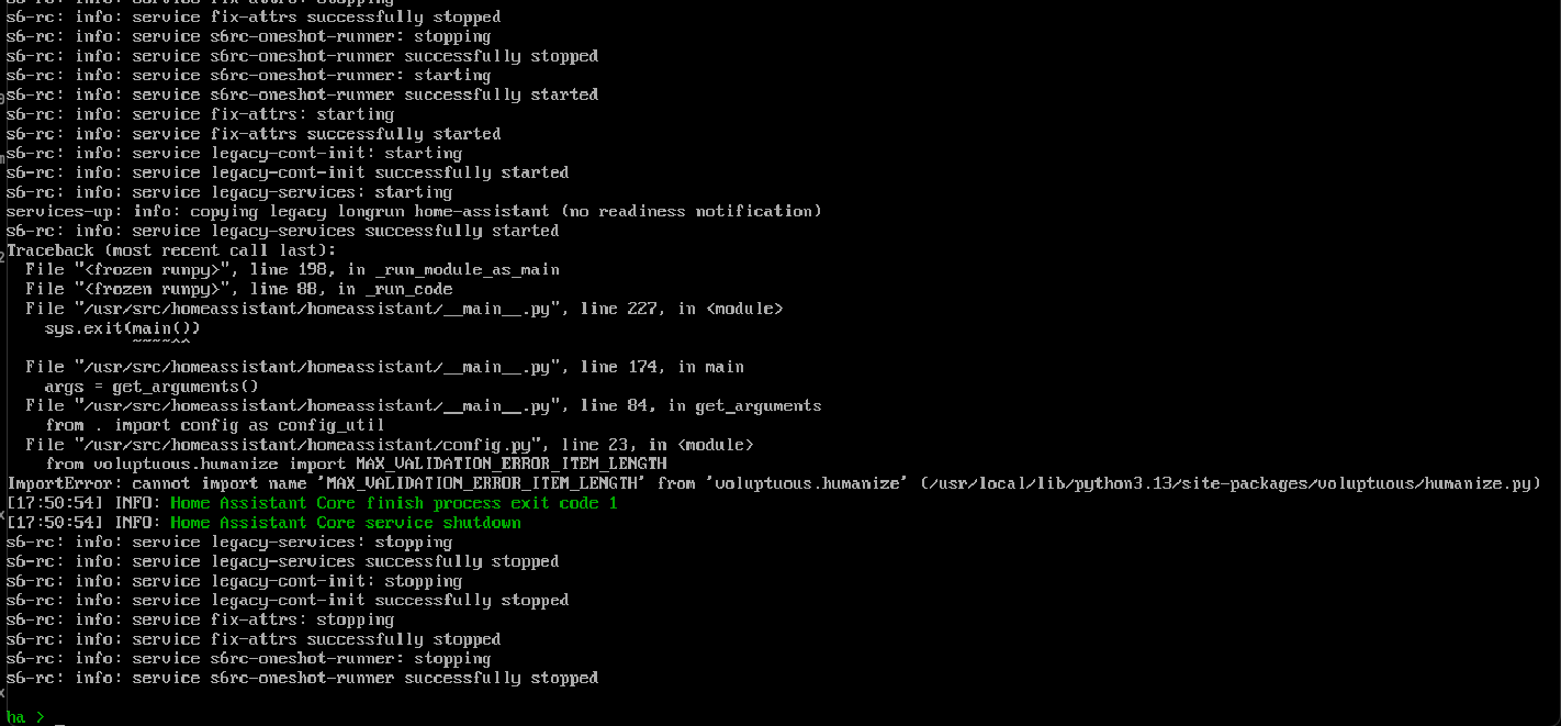

I’m suffering from this as well. Installed a qcow2 image on UTM on a M1 Mac, and I can access the observer url, both on ip and hostname, but not the home assistant url.
I’m seeing this when I run ha core logs, seems like an issue with how HA uses the voluptuous package:
