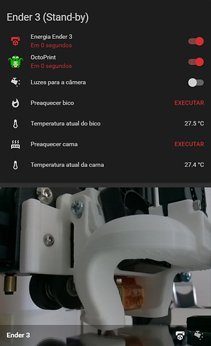

Hello! A friend of mine helped me and now it works like a charm. Here is the result:
octoprint_preheat_bed: "curl -s http://192.168.1.69/api/printer/bed -d '{\"command\":\"target\",\"target\":60}' -H 'Content-Type: application/json' -H 'X-Api-Key: 2BF5F70FDB884F528464F137A26544FD'"
octoprint_preheat_tool: "curl -s http://192.168.1.69/api/printer/tool -d '{\"command\":\"target\",\"targets\":{\"tool0\":100}}' -H 'Content-Type: application/json' -H 'X-Api-Key: 2BF5F70FDB884F528464F137A26544FD'"
Thanks!
Ah, the numbers have to be numbers, not strings. Makes sense.
Schneider
(Antonio Schneider)
November 9, 2018, 6:53pm
18
Here is the HA panel:
I believe this thread could help many people trying to integrate Octoprint with HA.
