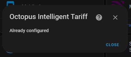

I think you need to delete and reinstall. when you go to settings > integrations and select the integration it should have a button for add - at this point a pop up should appear where you add your account details. If you already did that then you should have it already configured you should then see 1 device and (for me) 11 entities and a detailed display. Sorry I can’t add screenshots as I am not at my machine. If you are still stuck I can add screen shots later.
Is the binary_sensor.octopus_intelligent_slot broken, or is it just an issue with my installation?
I’ve seen some people mention that it’s broken and suggest using smoothing code.
I did try deleting and reinstalling it.

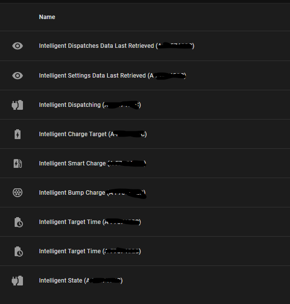

Hi, many thanks for all the work you do for people like me to dip my toe into this interesting arena of control. I’m late to the party on this but am here as like many other with EV on IOG and batteries trying to use HA to charge when IOG charges my car outside of the 11.30pm 50 5.30 am slots and stopping IOG draining my batteries. My question - or statement first is - I’m confused between ‘Intelligent dispatching’ and ‘Intelligent smart charge’. I’m sure one is for the normal 11.30 to 5.30 charge slot and the other I presume is for when Octopus charge outside of the IOG slot. Can anyone confirm which is which ? Many thanks
I get this but I don’t see the sensors relating to slot times
Intelligent dispatching tells you whether you are in a slot or not, but the allocated slots only show up in a card. I created a card on my dashboard using this code. that now shows me the slots

I believe the answer is that “smart charging” is the switch to turn intelligent control of the car / charge on or off
This I never touch
then there is intelligent dispatching which is the flag for whether you are getting charged or not

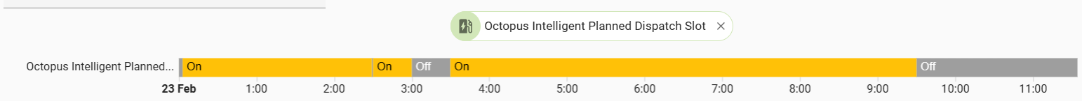

this is mine from last night. You can see that dispatching was off between 3 and 3:30, but the electricity was still off peak.

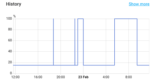

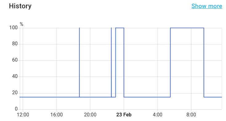

My battery automations (tesla powerwall) are to set the backup amount to 100% if despatching is on outside of 11:30 to 05:30, and when it goes off I just reset the backup to 15%
you can see above that the backup amount is set to 100% off peak in line with the intelligent slots.
I also have an automation to reset the backup at midnight so that powerwall can do it’s thing overnight in the ordinary off peak. The dispatching on automation is also triggered at 5:31 to reset the backup to 100% if dispatching runs past the end of off peak.

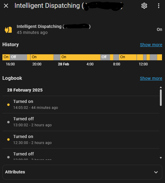

If dispatching is on then you’re on cheap rate. I believe the one exception to this is with the Ohme where if your car does not charge then you will not get the credit. With the Zappi it doesn’t matter if the car successfully charges or not, eg you unplug the car during the half hour slot, the slot ends but the 30 minutes is still on cheap rate.
IO gives lots of slots when demand is low and renewables production high outside of the core off-peak hours.
If you wanted to sense check, you could use “Current Rate Electricity” from your meter through the Octopus integration.
Just beware with dispatching it will not necessarily be ‘on’ during that fixed off-peak period anymore, even though you will be on your cheap rate. To capture both IO slots and the fixed off-peak period, use the ‘off peak’ sensor.
