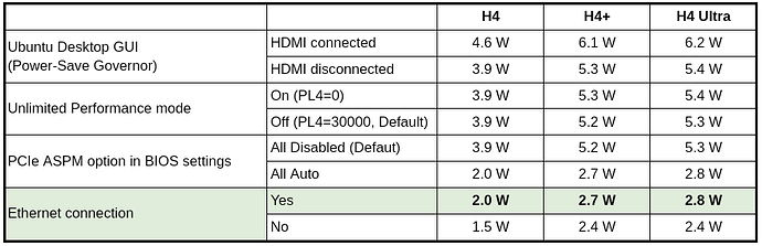

I appreciate that they listen to user needs and new models are improved based on the user feedback!
especially 2 models are very attractive: H4 Plus and H4 Ultra (with 8-core Intel N305) are interesting because they have 4x SATA III, 1x m.2, 2x LAN (2.5Gbit Intel I226-V)
