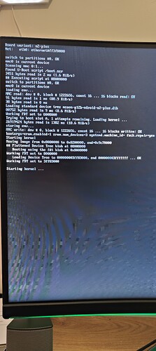

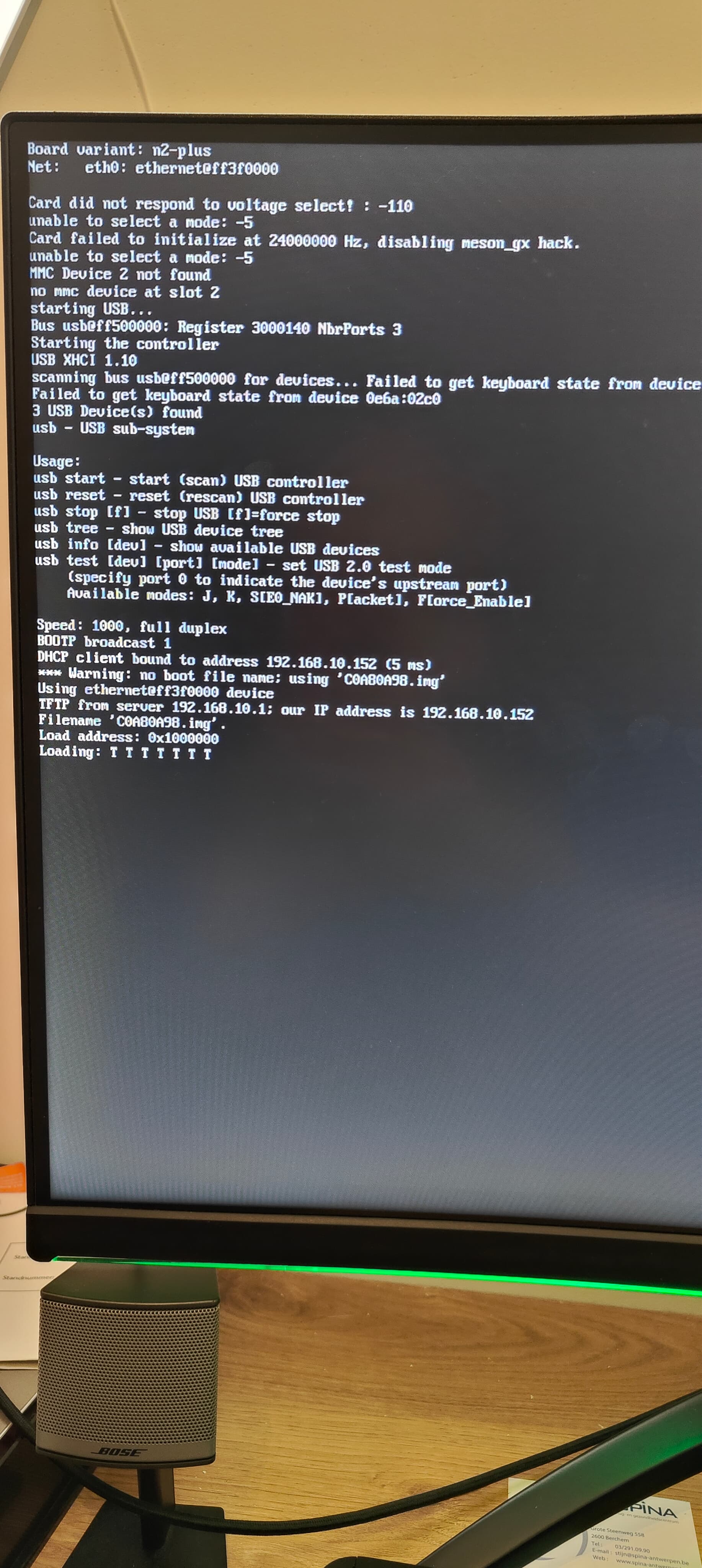

I then decided to put in an eMMC module. The Odroid wouldn’t boot, saying that it didn’t find an eMMC device.
Eventually, I was able to solve this by booting in SPI mode and in the menu edit the configuration.
There was a boot order:
(0) Any network device
(1) Any device
Changing this to
(0) Any device
solved the issue.
The Odroid now boots from eMMC without problem
PS: the Odroid still doesn’t boot from SD-card, I have no idea why. It reboots every time at “Starting kernel”
