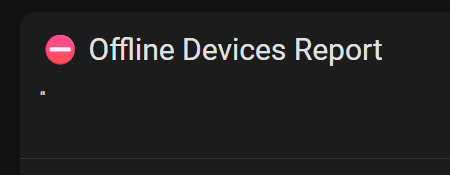

When it’s time and no issues I just recieve empty notification both on smartphone and Web UI, smth like that happens
No difference to use Enabled option or Enabled with no issues confirmation.
Also added custom action Telegram bot ontification and it sends empty message there too
Maybe your exclusions are making the list empty. Remove all exclusions, us the blueprint stock, then post what shows. You can also post your YAML… without that there is no way to troubleshoot
