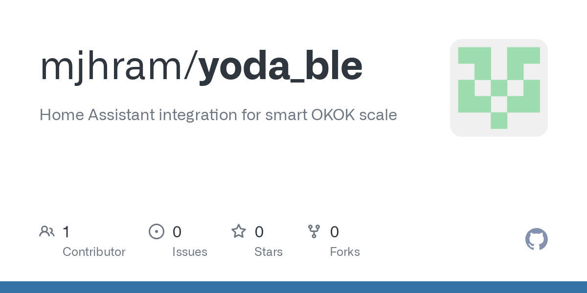

I have just published a HA integration for a scale that works on OKOK app.
All the details in the repo:
If you need help to integrate yours, just monitor the messages of your scale and publish them here.
to monitor the messages using raspberry pi internal bluetooth, use the following command “scan on” in “bluetoothctl” shell:
~$ bluetoothctl
[bluetooth]# scan on
I added integration, used MAC address from OKOK app, I see Yoda BLE Scale integration with 1 entity in HA. How do I use it? I do not see any weight anywhere.
me too, still waiting for any response from dev to help us
