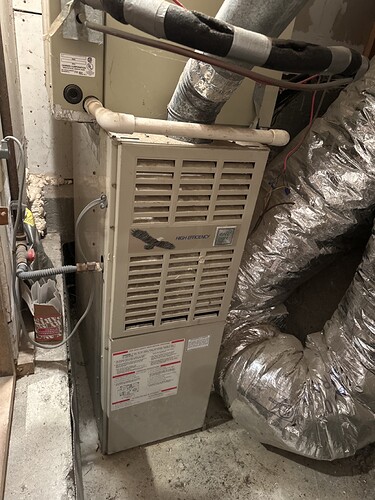

Thank you so much for your generous offer of support. I’ve attached pics of my three systems tho I’m not sure how much that helps.
I’m still very preliminary here, I haven’t even set up HA yet. I’m trying to understand the scope of what this will take and how to interface with the HVAC.
Two of them are Product: 395CAVC36055AAJA, Model: 395CAV036055.
The other I couldn’t find a model but Moore should know.
