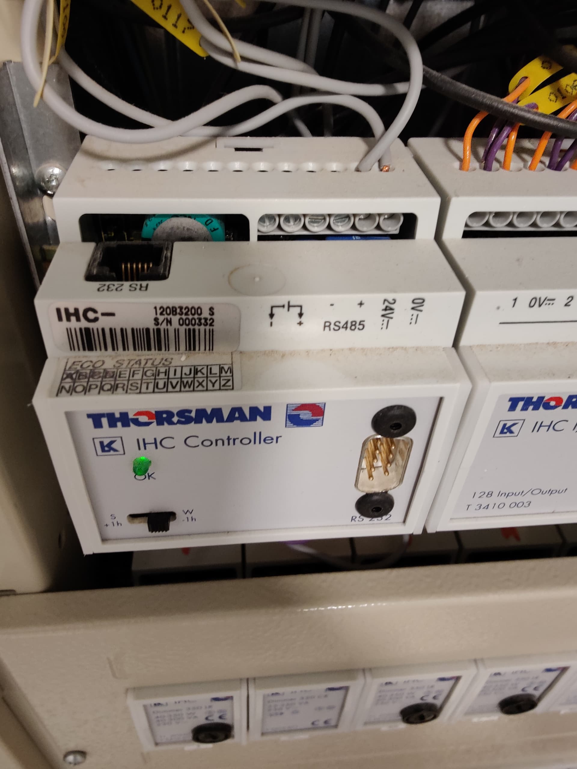

I’ve got an old LK (or ELKO) IHC WIN Controller unit (possible from around 2007) with a RS232 and RS485 connection. Does anyone know if it is possible to integrate it with HA? Maybe @dingusdk would know? How do I connect it to HA? Where to start?

The newer IHC controllers have an ethernet connection and we can use this to interface from HA to the IHC controller. You cannot use the older controller with any of the existing IHC HA integrations.
I may be possible to do something on the RS485 or the RS232 port. There is no official documetation available for this. I think the communication on the RS485 port is related to the modbus protocol, if you want to try and do some reverse engeniering yourself.

I did integrate the older IHC Visual Controller (the one without ethernet) a couple of years ago successfully.
Used Martin Hejnfelt’s GitHub - skumlos/ihcserver: Server daemon for LK IHC controllers with RS485 interface for connecting to the controller via RS485 and wrote a small script that communicates between ihcserver and HA.

Very interested! I just rented a place with one of these systems, and would love to automate it. Have a raspi to run the software on, would love to know how you integrated it!

I will put something up then. Which model of the IHC controller You have there?
