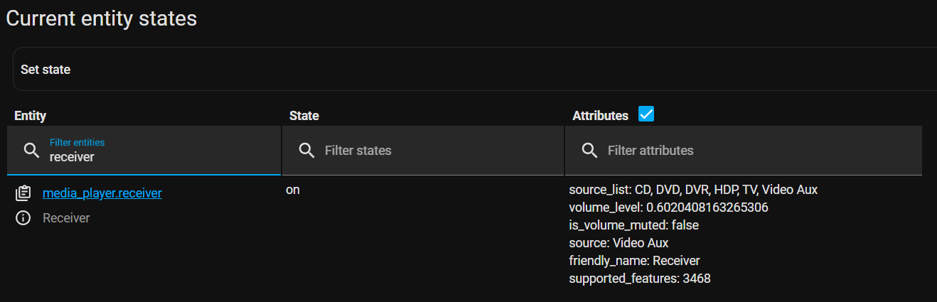

Thank you! Very clear instructions. Managed to get it up and running So far i see something similar to your screenshot above. how do I add control for Zone2? Thanks
I was afraid you might ask me that. :wink: I don’t believe the media_player component for Home Assistant has functionality for zones unfortunately. I actually gave up trying to get Zone 2 stuff working with the custom component so I think there’s left over code in there from my attempts. I ended up controlling Zone 2 stuff with an IR blaster instead. Having the media player for the main part was most important to me anyway because of the feedback. I have the receiver status’: power, mute, input selected and volume settings displayed in my dashboard.

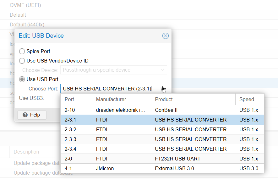

This happens to me occasionally as well. I’m running HAOS in a VM on Proxmox. I find I have to go and remap the USB passthrough once in a while for whatever reason. I’m using a 4 port USB serial device. My Denon is on the second port, port 1 of the device. This is my Proxmox USB hardware setting for the first 2 ports from my notes:
usb0: host=1-3 <-Insteon FT232R USB UART
usb1: host=1-4.1 <-Denon
But the first part of the number can change on occasion. For example, the above is from my notes on the topic but when I look at current settings in Proxmox they are set to:
usb1: host=2-3.1 <-Denon
After the change and restart of the VM things usually line up and start working again.
Don’t know if that helps at all. I know this can be frustrating.
Garry
