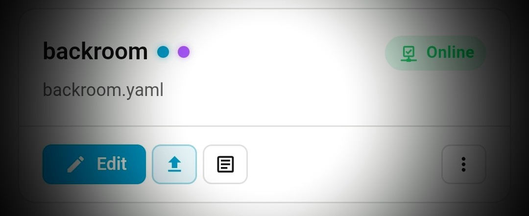

where to find these logs ?
Karosm
(Karosm)
4
Where you upload the code..
Spiro
5
It’s 2 to the right of edit
Are you holding the button down for 2-3 seconds ? That seems like rather a long time to press a button.
