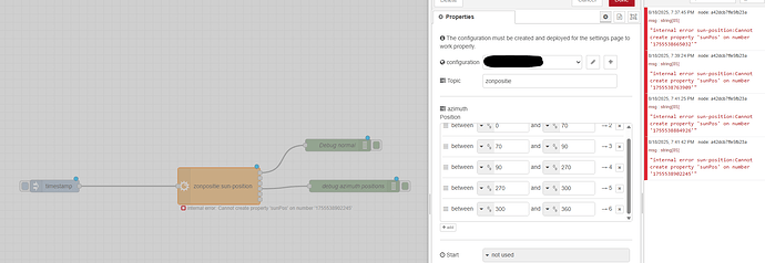

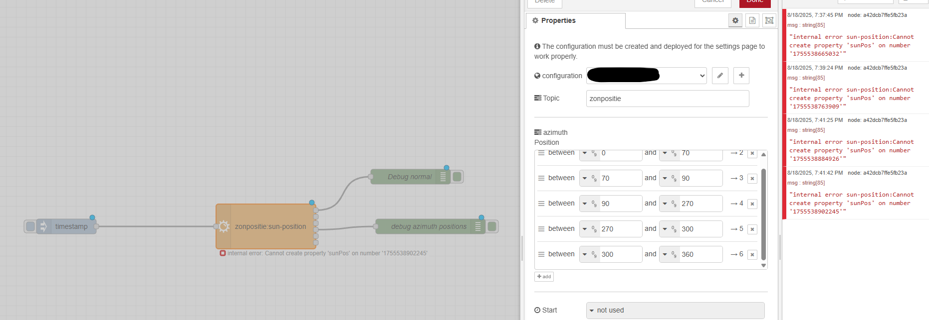

Why is it that the sun-position node returns an error when it’s in one of the azimuth positions, and doesn’t return an error when it’s not in one of the configured azimuth positions?
It maybe better to ask this on the nodes git page since it is very specific to the nodes behavior. You could use a catch node to catch and log the error in a way that you can trigger from it.
I miss read that, basically it doesn’t work at all? Configured result in error and un configured does nothing?

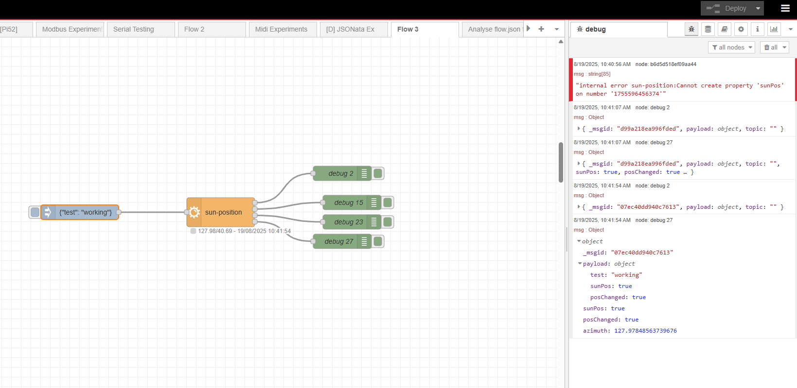

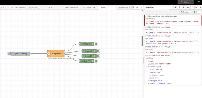

Edit. I used the example flow from the nodes documentation and I get that error if the azimuth is within a configured range. It appears to be a bug.
It seems this issue has been around for a while. You could always use a change node after to sort the azimuth.
When in the configured azimuth position, the node appears to be adding fields to the input message.
Adding a property (field) to something that is not an object will generate this error - you can’t add {“sunPos”: true} to a number.
You can, however, add properties to an object. Just set msg.payload to an object (even {} works) and then the node functions.
Not a bug, just a ‘feature’.
great, this does the trick! this wasn’t clear to me in the documentation :slight_smile:
