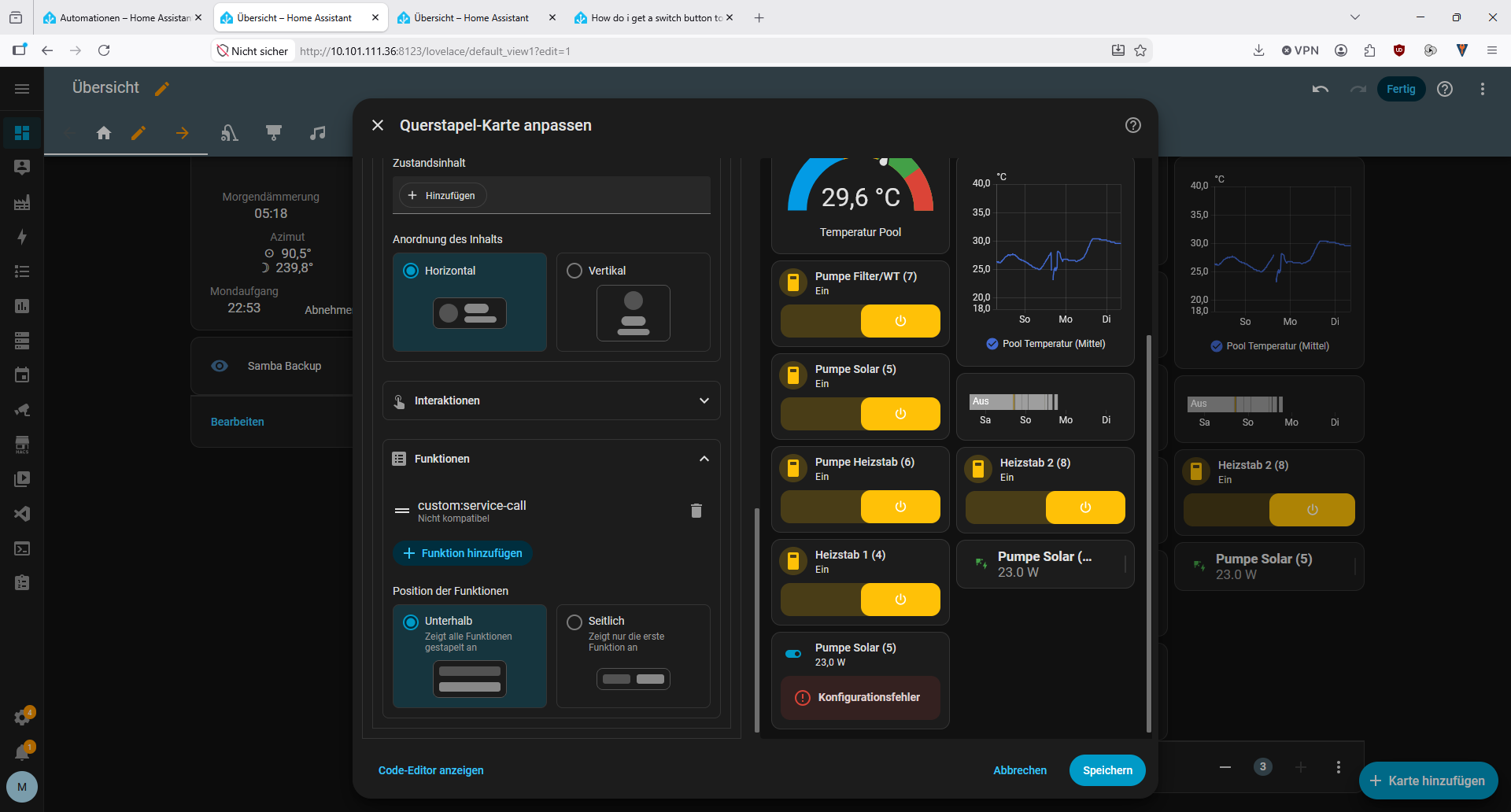

One button, that togles a switch and shows consumption and opens the consumtion moreInfo... here is an example of how that can be done
yea basically the topic.
i try to have my pool equipment in HA. mainly the pumps.
So i have a button to switch them.
what i want on long press is that my dashboard opens up the histogram for power consumption of that switch. (for the pool pump (5) the entity would be sensor.steckdose_12_25_05_leistung)
i tried all i know myself, then asked gemini, chatgpt… used the stock switch card, the button card, the mushroom card, and i am staring at a all around failure to make it happen…
where am i going wrong?

One option would be to use the Custom Card Features:
type: tile
icon: mdi:toggle-switch
features_position: bottom
name: Pumpe Solar (5)
entity: sensor.steckdose_12_25_05_leistung
color: primary
hide_state: true
features:
  - type: custom:service-call
    entries:
      - type: toggle
        entity_id: switch.steckdose_12_25_05
        icon: mdi:power
        tap_action:
          action: toggle
          data: {}
        autofill_entity_id: false
hold_action:
  action: more-info
tap_action:
  action: none
Thanks, I’ve tried that, and my up to date HA reports the custom service call to be not compatible with the entity sensor…
I did run into that specific issue quite a few times…

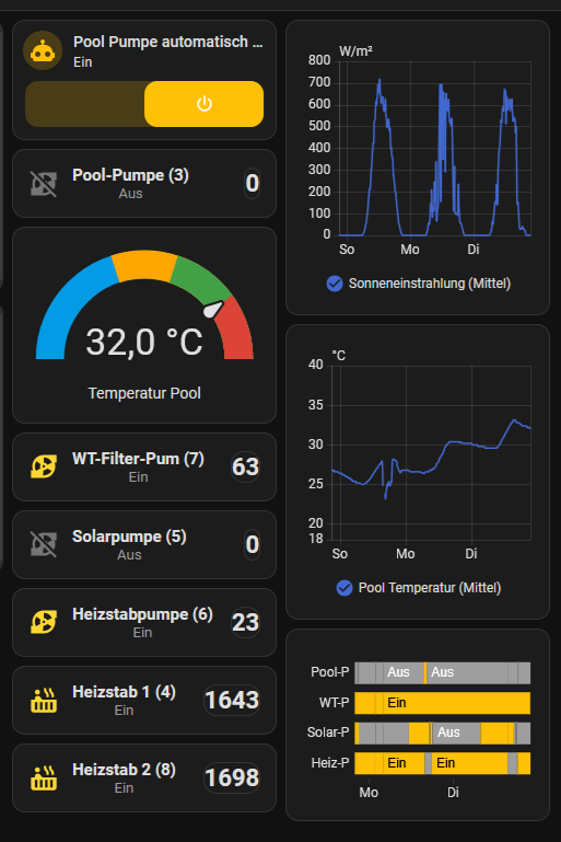

After a lot of finagling I pretty much got it to look the way I wanted, and also behave the way I wanted: If i tap left, it switches the entity, if i tap right, it shows the moreInfo consumption card.
this is all due to me adding an other heat exchanger to my pool and house circuit. currently I switch everything with nous A1Z smart zigbee sockets, hence the nameing (socket_date-of-purchase_running-number (for warranty reasons, my batch of A1Z have proven to be very unreliable if tasked above 50% of rated load (16A) or switching magnetic valves). In the future I will upgrade to a DIN rail distribution and add 63A Smart Breakers for DIN rail to hook everything up.
Since I have both kinds of solar, i “waste” my over electric capacity into heating water, including pool. if the forcast projects that I don’t have overcapacity from my roof, then i use a heat pump to heat it. besides that, i always have a 6m² hot water CPC vacuum collector on the roof too, that also feeds the pool if my hot water tank is all heated up.
thats how my pool monitoring and control panel looks:
and thats the code for it:

          power:
            card:
              type: custom:button-card
              entity: sensor.steckdose_12_25_06_leistung
              show_icon: false
              show_name: false
              show_state: true
              state_display: |
                  const state = states['sensor.steckdose_12_25_06_leistung'].state;
                  const value = Number(state);
                  if (state === 'unknown' || state === 'unavailable') {
                    return 'Offline';
                  return Number.isFinite(value) ? Math.round(value) + '' : 'Offline';
              tap_action:
                action: more-info
              styles:
                card:
                  - background: none
                  - box-shadow: none
                  - padding: 0
                state:
                  - font-size: 22px
                  - font-weight: bold
        tap_action:
          action: toggle
      - type: custom:button-card
        entity: switch.steckdose_12_25_04
        show_name: false
        show_icon: false
        show_state: false
        styles:
          grid:
            - grid-template-areas: "\"left power\""
            - grid-template-columns: 1fr 90px
          card:
            - padding: 14px
            - border-radius: 12px
          custom_fields:
            left:
              - justify-self: start
              - align-self: center
            power:
              - justify-self: end
        custom_fields:
          left: |
              const on = entity.state === "on";
              return `
                <div style="display:flex;align-items:center;gap:12px;">
                  <ha-icon
                    icon="${on ? 'mdi:hot-tub' : 'mdi:heating-coil'}"
                    style="color:${on ? '#fdd835' : '#757575'};width:28px;height:28px;">
                  </ha-icon>
                  <div>
                    <div style="font-size:15px;font-weight:600;">Heizstab 1 (4)</div>
                    <div style="font-size:13px;color:var(--secondary-text-color);">
                      ${on ? "Ein" : "Aus"}
                    </div>
                  </div>
                </div>
          power:
            card:
              entity: sensor.steckdose_12_25_04_leistung
              show_icon: false
              show_name: false
              show_state: true
              state_display: |
                  const state = states['sensor.steckdose_12_25_04_leistung'].state;
                    return 'Offline';
              tap_action:
                action: more-info
              styles:
                card:
                  - background: none
                  - box-shadow: none
                  - padding: 0
                state:
                  - font-size: 22px
                  - font-weight: bold
        tap_action:
          action: toggle
        entity: switch.steckdose_12_25_08
        show_name: false
        show_icon: false
        show_state: false
        styles:
          grid:
          card:
            - padding: 14px
          custom_fields:
            left:
            power:
              - justify-self: end
        custom_fields:
          left: |
              return `
                  <ha-icon
                  </ha-icon>
                  <div>
                    <div style="font-size:15px;font-weight:600;">Heizstab 2 (8)</div>
                    </div>
                  </div>
                </div>
          power:
            card:
              entity: sensor.steckdose_12_25_08_leistung
              show_icon: false
              show_name: false
              show_state: true
              state_display: |
                  const state = states['sensor.steckdose_12_25_08_leistung'].state;
                    return 'Offline';
              tap_action:
                action: more-info
              styles:
                card:
                  - background: none
                  - box-shadow: none
                  - padding: 0
                state:
                  - font-size: 22px
                  - font-weight: bold
        tap_action:
          action: toggle
  - type: vertical-stack
    cards:
      - type: statistics-graph
        entities:
          - entity: sensor.ws2900_v2_01_10_solar_radiation
        days_to_show: 3
        period: 5minute
        chart_type: line
        stat_types:
          - mean
        hide_legend: false
        logarithmic_scale: false
        fit_y_data: false
        entities:
          - entity: sensor.tz3218_7fiyo3kv_ts000f_temperatur
            name: Pool Temperatur
        days_to_show: 3
        period: 5minute
        chart_type: line
        stat_types:
          - mean
        hide_legend: false
        min_y_axis: 18
        max_y_axis: 40
        fit_y_data: false
      - type: history-graph
        entities:
          - entity: switch.steckdose_12_25_03
          - entity: switch.steckdose_12_25_07
          - entity: switch.steckdose_12_25_05
          - entity: switch.steckdose_12_25_06
        hours_to_show: 50
        show_names: true
