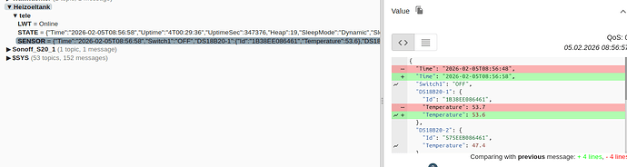

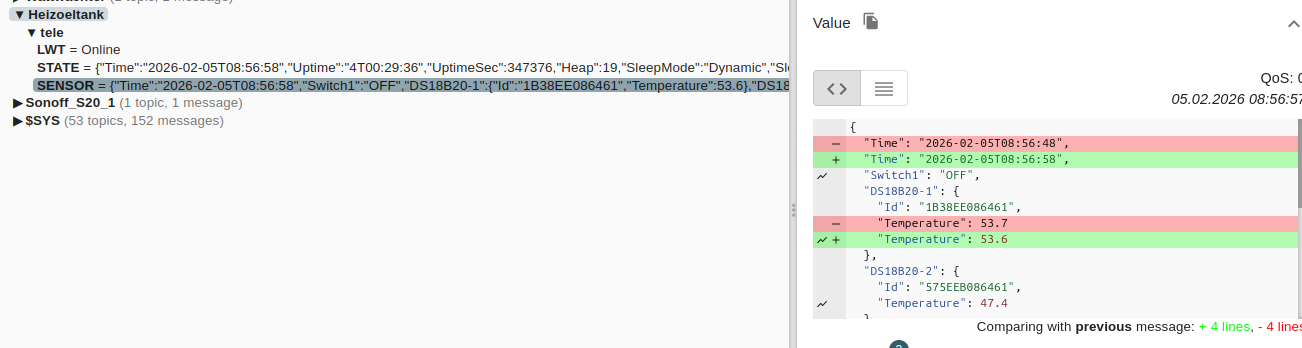

In the MQTT explorer, all sensors including the switch/relay are also showing up.
But the switch/relay is not showing up in HA.
Is the switch only coming up, when triggered?
The problem is, that I cannot simulate a trigger.
So, how can I setup an automation on that switch?

The switch itself is not showing up on the Tasmota UI, only in the console log (and via MQTT explorer)
