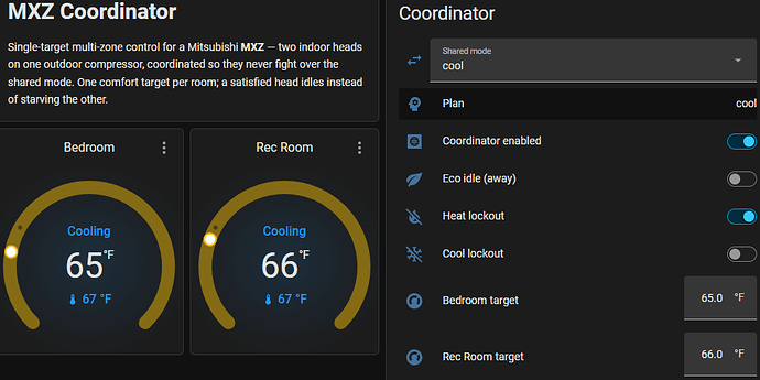

The coordinator becomes the sole writer of your heads, and three rules replace the
stock logic:
- Never hardware AUTO. Every head runs one explicit shared mode — cool or heat —
chosen from your real room temperatures against your targets. - A satisfied room steps aside. It idles in
fan_only, which closes that head’s
refrigerant valve (it’s in the service manual), instead of blocking its neighbors. - When rooms disagree, your priority wins. The room you ranked first gets its mode;
the other coasts. A 10-minute lockout gates every mode flip, so nothing oscillates.
On top of that, the parts I ended up caring about most day-to-day:
- One number per room, Tesla-style — set a temperature, and mode, fan, and
arbitration happen in the background. Clean single-setpoint tiles for
HomeKit/Google/Assist. - A fan that responds to need — runs harder the farther the room is from target,
eases off as it arrives, and returns toautowhen satisfied. Pick a speed by hand and
it’s your hold — the coordinator stops touching that fan until you hand it back (a
per-room Fan auto switch bridges the handback into Apple Home). Holds survive
restarts. - Local-weather changeover — point it at any
weather.*entity and heating locks out
in the warm season, cooling in the cold one, from your own forecast. No calendar, no
cloud. - It tells the truth — a plan sensor exposes every decision input live (per-room
demand, who’s coasting, who holds the fan), so “why did it do that?” always has an
answer. If your firmware publishes real blower speed (CN105/ESPHome does), the tile
shows actual airflow instead of freezing on the last commanded speed. - It doesn’t break — self-heals a head knocked off plan, fails to neutral on sensor
dropout, survives restarts, clamps every setpoint to what each head actually accepts
(including the °F/°C rounding trap where a head advertises 79 °F but rejects it),
and one kill-switch hands your heads back instantly, frozen where they were.
