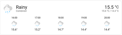

One weather entity to rule them all
:cloud: Background
As many users of Home Assistant I have automations depending on weather conditions. For example sun covers need to close if the current condition changes to rainy or you want alerts to close the window if the outside temperature exceeds the inside temperature on a hot day.
However, it could be that the weather integration you are using is (temporarily) unavailable, which will make your automations fail.
To prevent this I created a template weather entity, which combines all data of the other weather integrations you use.
:question: How does it work?
The weather information is updated every hour, by generating a list of all weather entities (excluding template weather entities) and using the weather.get_forecasts entity on each entity in this list. It checks for all forecast types (daily, hourly and twice daily)
:chart_with_upwards_trend: Other (binary) sensors
Besides creating a weather entity, it also creates some other sensors which can be useful in automations:
  • Highest forecasted temperature of the current day
  • Highest forecasted tempearature of the next day
  • The forecasted condition of the current day (which is not necessarily the current condition)
  • A binary sensor which will be on if sun is expected in the next 3 hours

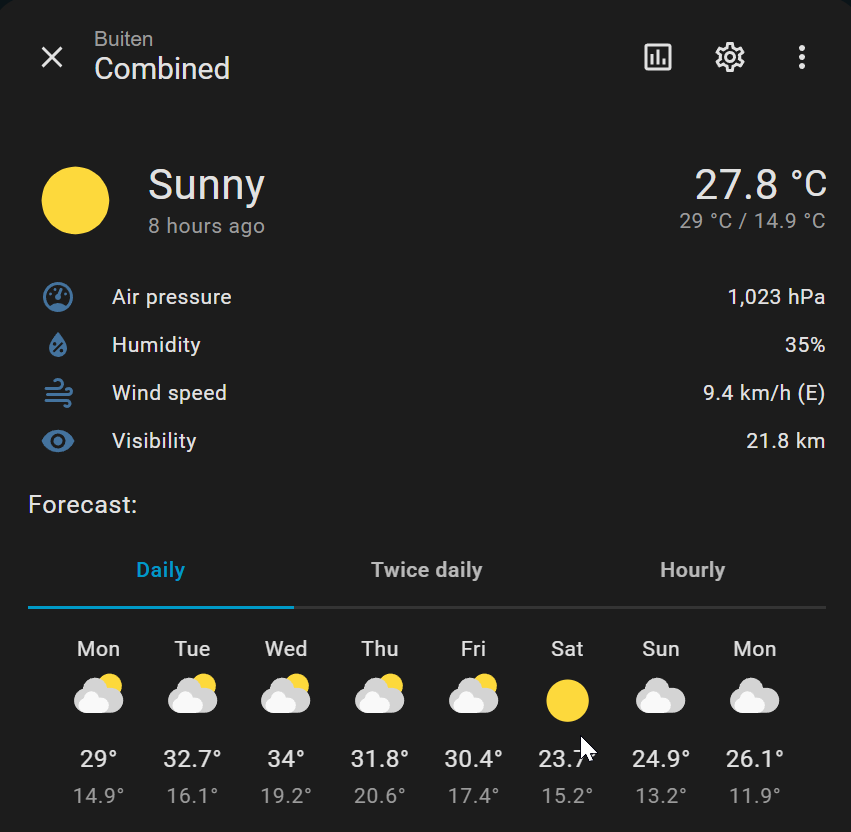

Worked really well initially, but sometimes I don’t get the hourly or daily data under the forecast. In other words, instead of this:
I get this:
I’m using the Android companion app, and I can’t reproduce the problem at will, I’m afraid.
Edit: The same issue appears in two different dashboards, though.
Any issue under the template integration in your log? And what does sensor.weather_forecast_entities show in developer tools > states?
Problem’s gone now (after a restart for something else). I’ll keep an eye on it and get back to you if it returns.
