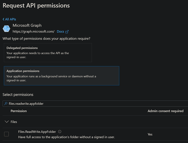

Looking at the available permissions to assign via app registrations (correct me if I need to be looking in a different place or if this isn’t the right thing) but it does give the option for Files.ReadWrite.AppFolder as an option. Is that not what you’re needing for this?
And I’m happy to help test/troubleshoot if you need someone with a 365 Business subscription to see if things work the same way.
Edit: it’s also listed under delegated permissions but has (preview) added to the description.
No.
