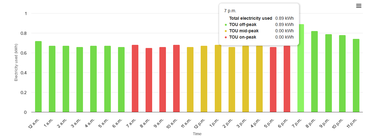

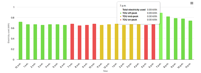

Hey folks, just wanted to share that I was able to have my Toronto Hydro data automatically imported. It lags behind a day but otherwise works pretty well.
It mostly relies upon some work done by others (web scraping to download the data, and a custom integration to import it), so original credits to them. I forked & edited the web scraping tool because the website had been updated since it was written.
Instructions for home assistant are here
Is the xml being parsed ok? I have a report that Toronto Hydro provides uom of 38 (Watts). I haven’t heard back if it also provides uom 72 (Wh).
yeah, the data being displayed in homeassistant matches what’s shown in the hourly breakdown on my account (0.89kWh from 7-8pm)
