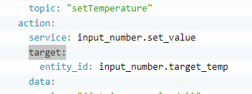

running_script: false
but in HA the input field still displays 1600 and if i change this input filed tin HA to any othe number then 1600 the change is shown some seconds later in the DTU.
The same happend, if i change the input filed in Developer view. it dos not work.
Maybe target: is missing.

Screenshot 2024-06-29 101029
Not Working :frowning:
You have to use to service “number.set_value” (not input_number.set_value)
