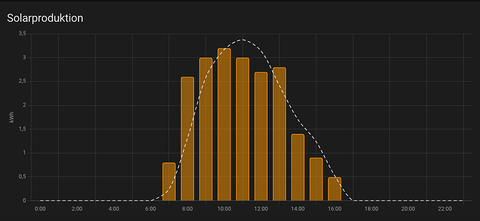

This integration is truly wonderful thank you so much for contributing it to the community! I apologize if this has been answered before but I did not see the answer.
Using the default recommended Value for DC efficiency (0.93) the projected generation at mid-day is massively higher than reality. Morning and evening are extremely close without any tweaking. I’ve dropped this DC Efficiency value down to 0.78 to bring things in line with reality and my system is now tracking extremely close to the predictions.
I suppose the question I have is why is this happening? The predictions with my current settings seem to be reliable so I’m very pleased but it is puzzling?
My system is composed of REC420AA panels and Enphase IQ8M-72-2-US micro-inverters that are supposedly 97.8% peak efficiency according to their spec sheet (I understand this is a best-case theoretical value).
The Azimuth and Declination values I’ve entered appear to be accurate as the predicted generation by https://pvwatts.nrel.gov/ aligns very closely to my actual production using the same values I’ve entered into the Open-Meteo Integration.
Thanks again!

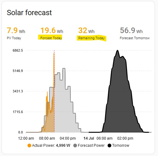

There are days when the forecast curve looks really good and sometimes it looks like the curve is off by an hour.
Good:
Issue:
Has anyone seen this before and has an idea/solution?

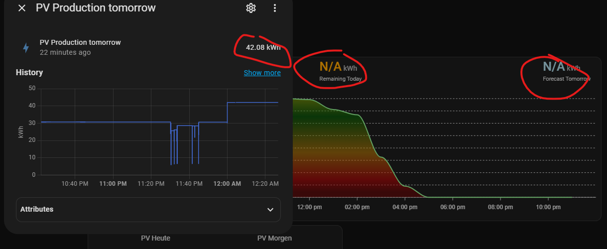

Hey, any idea why values are showing with N/A even there are value available?
