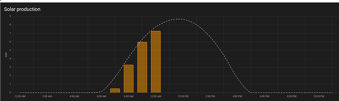

This is with this configured for 2 arrays at a 95% efficiency, based on my DC panels size, not inverter size:
And this is Solcast for the same 2 arrays:
